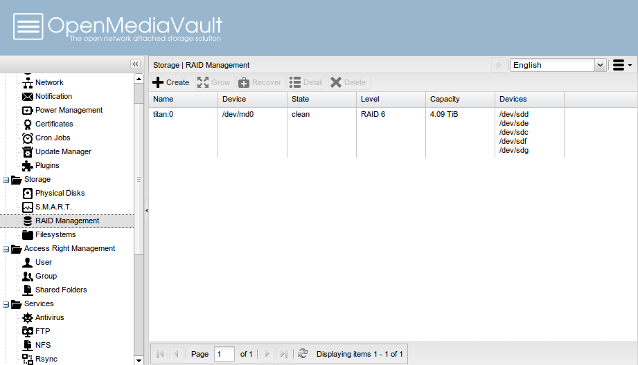

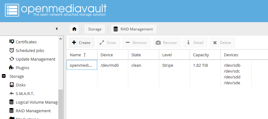

Whoops, should have checked my terminology on that one. Meant Raid Array from the RAID management menu (Pic from OMV’s Screenshot page):

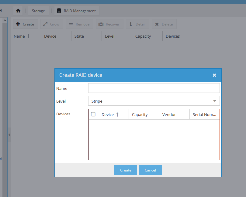

Looks like I still can’t add any disks to a raid array:

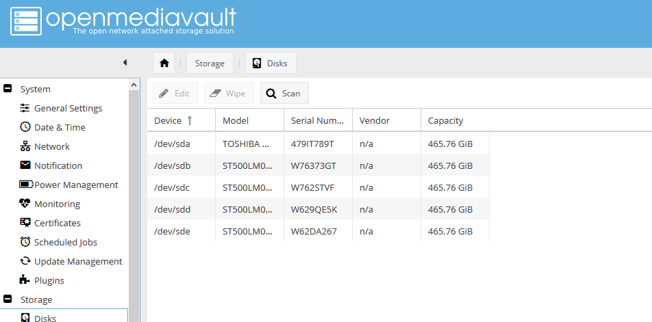

Even though I can see all of the disks are identified and I have used the built-in tool to wipe them all:

Success in creating the raid device when using mdadm from the terminal, it even shows up in the UI. Not sure if I was meant to do something completely different or not…

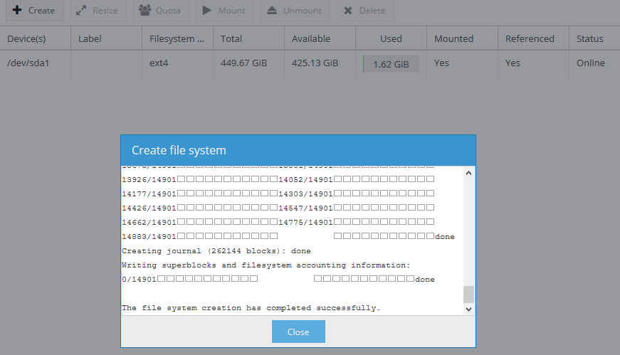

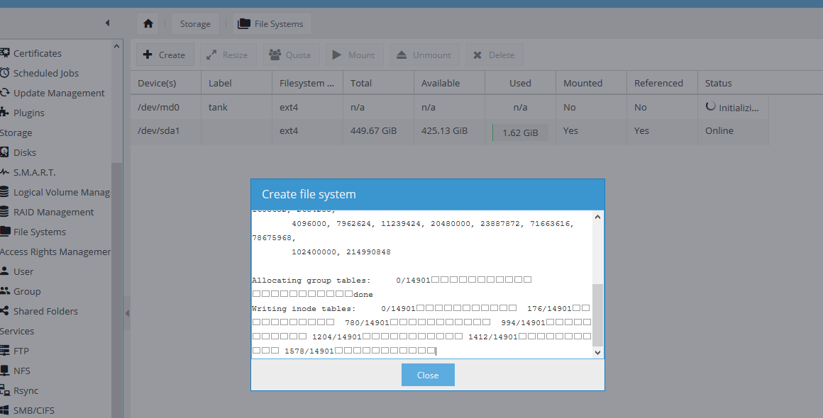

Now any filesystems created disappear after the confirmation dialogue reports success:
Lol, is there anything you guys can see that I’m doing wrong here? Or is the GUI just reporting false positives?
The gui has been buggy for me with both fs creation and networking stuff.
Just create the raid on cli then use the gui for mounting.
