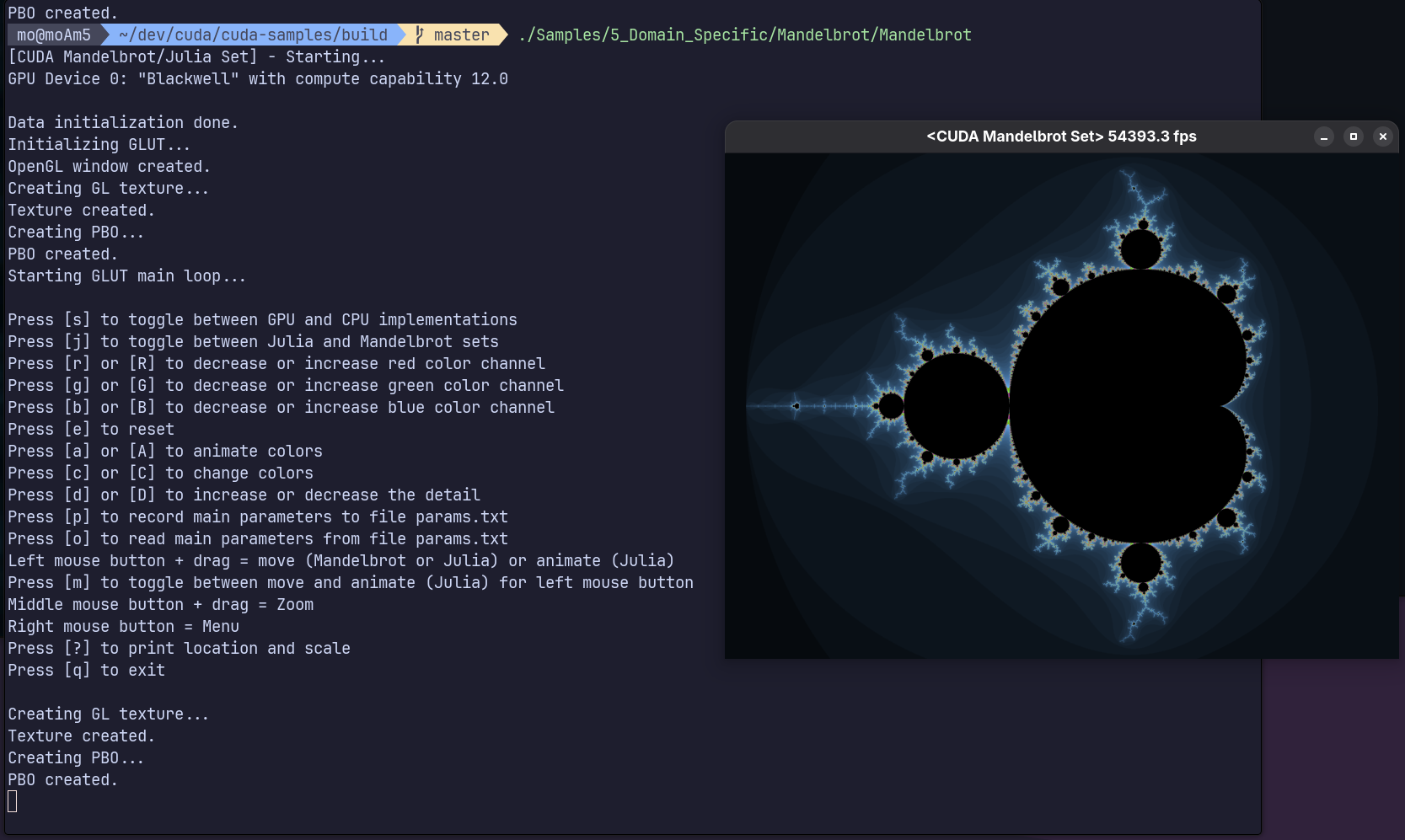

Grab a cuppa tea and wait (or not). If all goes well, we should have projects we can now run. In the same build directory, let’s run two of my favorite examples
./Samples/2_Concepts_and_Techniques/MC_EstimatePiP/MC_EstimatePiP # simple monte-carlo algorithm for estimating Pi
./Samples/5_Domain_Specific/Mandelbrot/Mandelbrot # tests OpenGL with CUDA, use `+` and `-` to zoom in and out

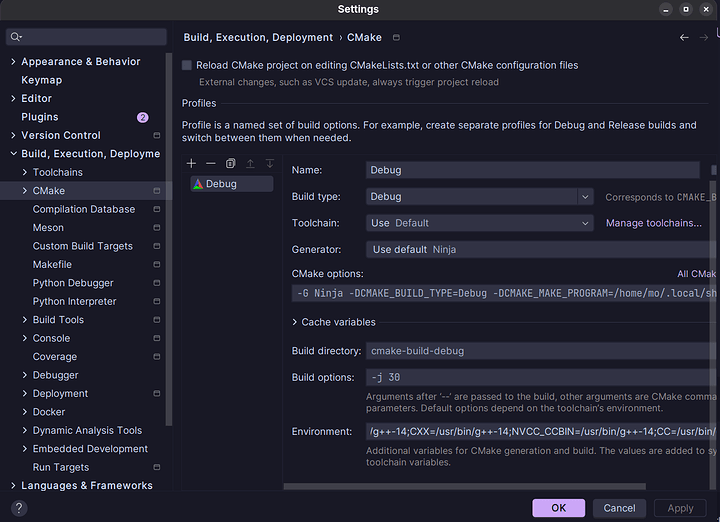

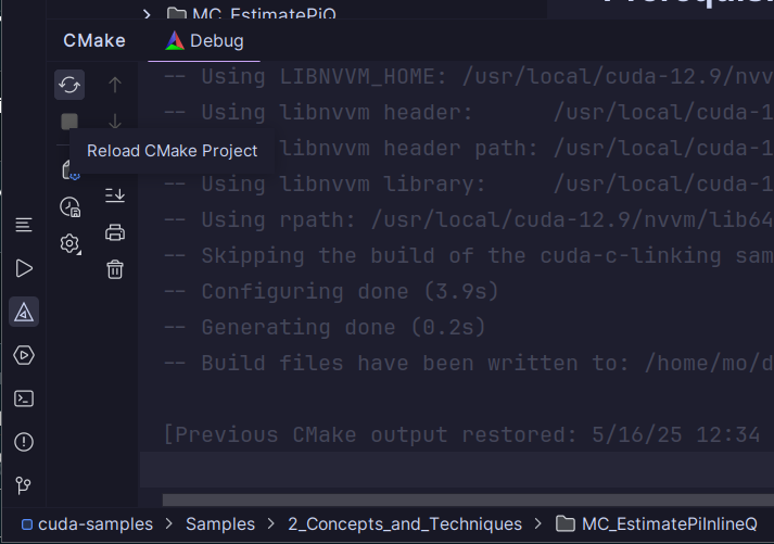

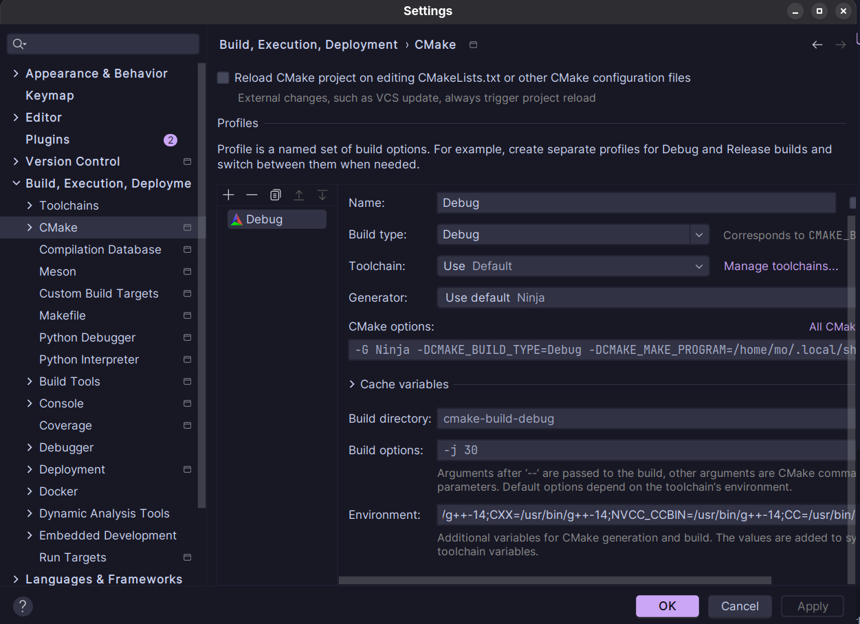

BONUS: Working inside CLion
Open the root project directory where the CMake with CLion. You will notice that cmake won’t initially work. That is because you need to add the environment variables we have above there:
Go to Settings → Build, Execution, Deployment → CMake and add the following in Environment:
CUDAHOSTCXX=/usr/bin/g++-14;CXX=/usr/bin/g++-14;NVCC_CCBIN=/usr/bin/g++-14;CC=/usr/bin/gcc-14
Then reload the CMake project, which you can easily do from the bottom left corner of the IDE
