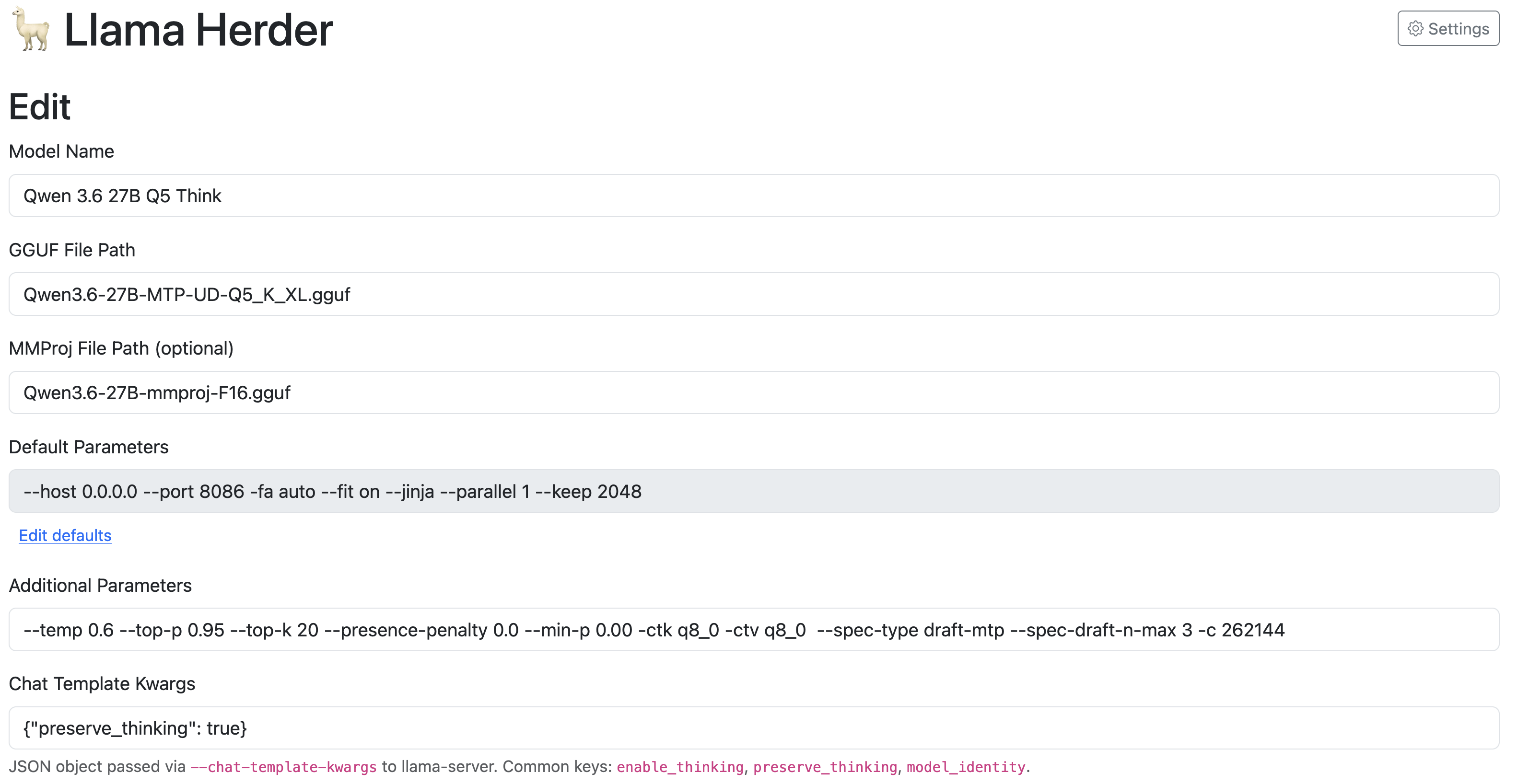

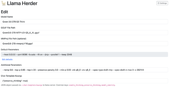

There’s a LOT to learn about model formats and quants and sampler settings and chat templates (not joking this time, very very deep topic), I’d recommend hanging out in the Reddit localllama sub for getting deep on the topic. But basically you’re always picking a GGUF formatted model in a specific quantization level (Q4/5/6) and providing the sampler settings that are appropriate for the model and sometimes messing with the context size, the kv cache format and a few other things. To shortcut, here’s the settings I use for Qwen 3.6 27b:
This is a screenshot of my model switcher. You don’t need to use one of these as the newer llama.cpp server has a built in switcher, but I use mine to control all the startup params. The model name here is just a field I provide, the GGUF I use is the Unsloth Qwen 3.6 27b with multi token prediction in Q5 UD (5 bit weights by variable by layer to preserve quality) quant. The host and port can be anything you want (0.0.0.0 means accessible across the network). -fa auto turns on flash attention if needed (this model needs it), -fit on means fit all the layers to the hardware you have in the best way possible, –jinja means use jinja templating for the chat template, this is not optional but default I think nowadays. For agents you’ll need it. –parallel 1 means don’t allocate memory for multi tenancy, also increases token gen rate, –keep 2048… this is harder to explain, it means it’s going to keep the first 2048 tokens from the prompt and tool definitions for when you exceed the context window and llama.cpp is going to context-shift the current conversation. You WANT this to maintain reliability in longer exchanges. –temp 0.6 --top-p 0.95 --top-k 20 --presence-penalty 0.0 --min-p 0.00 are all the sampler settings I mentioned above. This is the recommended setup for Qwen 3.6 doing agent work. You can check Unsloth’s guide to running the model for other settings. Don’t think about it just use these. -ctk q8_0 -ctv q8_0 means run the k/v cache for the model in 8 bit mode instead of 16 bit. This results in some detail loss but allows you to run full context window sizes. –spec-type draft-mtp --spec-draft-n-max 3 means the model will do multi token prediction which is a HUGE bump in token gen performance, for the price of a bit of extra vram. For dense models like the 27b, you WANT this. -c 262144 just means run the model at full 256k context. You CAN run 128k or 64k if you want, and some people will claim it’s better, but you’ll be hitting the VERY SLOW context-shift quite often when it’s doing more complex tasks. These same settings can be used on the 35b MoE model. This is pretty much maxed out performance for intelligence/speed for the 27b dense. You’ll need every bit of it for an agent harness.
