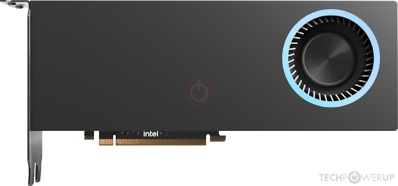

  1. Would I be able to get decent performance with relativly large LLM’s running on, for example ARC pr B60 which is the GPU my father has been looking at primarily?

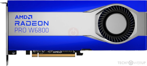

  2. Should I be looking at alternatives for the ARC pro 60 24GB? Looking at Ebay, maybe also Radeon W6800 32GB is an option?

The Arc Pro b60 is around 900e

The pricing is pretty atrocious, I must say. From these options, the B60 Pro is the cheapest although certainly not the most performant.

Single GPU setup I’d recomment at least the Intel B65. It has 32GB of VRAM. You could either run a smaller (like Q4_0) Quant of Qwen3.8-27B completely inside VRAM or you could use something like ik_llama.cpp to load a larger model like Qwen3.8-Flash-Next. Though the issue with CPU offloading is you also don’t have much RAM.

Well, at least for me, it looks being around 1350€ or so. Around the same price as the RTX 3090 but might be out of budget. I was also looking that I might also be able to get a W6800 32GB for around 900e…
So, would it make more sense to get the Radeon pro W3800 32GB or Arc Pro B60 24GB? Well, debating this rn
W6800 or RDNA2 doesn’t have dedicated matrix multiplication cores so it might be slower in general.
