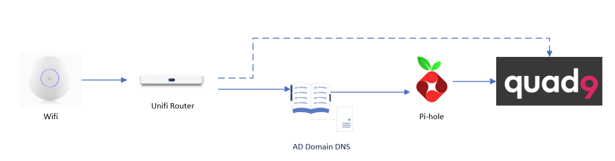

Got a bit of a dilemma right now because of how DNS works. Before I go into the question proper, I have somewhat of a network DNS solution like the one below:
The reason for this set-up is that:
  • I run an AD at home (yes)
  • I need to have the Domain to answer DNS calls for Domain exclusive purposes so it needs to be in the chain
  • Pi-hole sinkholes anything telemetry from all of the network environment
  • Fallback for the overall network to Quad9 directly (dotted line) in case of issues
All of the hosting infrastructure is within a hypervisor, so if I’m troubleshooting the hypervisor, the AD is off and most likely the Pi-hole will be off at the same time. This setup works, including the fallback (useful when you have more than just one person in a household), but the problem is that the Unifi Router doesn’t switch back to the main DNS once it comes back online, and I would like for it to switch back to the AD/Pi-hole path.

I could do DNS forward to the AD for the domain only, and then the rest to Pi-hole directly, but the challenge still is when both go offline (which is probably 90% of the times) how do I tell Unifi to go back to these DNS servers rather than Quad9 directly
To be sure: The clients receiving DNS servers from the Unifi DHCP are receiving Unifi’s gateway, or the AD server?
i.e. Client → Unifi DNS → AD DNS → PiHole → Quad9, instead of Client → AD DNS → PiHole → Quad9
When you say ‘fallback’, is that a separate host/hypervisor running DNS, or are you having DHCP hand out two DNS servers – one of which is the AD DNS stack and the other of which is quad9?
The ‘simple’ and/or ‘correct’ solution would be another hypervisor running a duplicate of your AD DNS->Pihole stack, and handing out only the AD DNS addresses via DHCP. That way you can mess around with one hypervisor and the other one is still serving traffic in your preferred way. Of course, the correct solution involves expense. :yay: But maybe you have an old PC lying around somewhere that’s getting voluntold into this new lease on life.
As far as the ordering of DNS goes, PiHole’s conditional forwarding could be in front of AD DNS (i.e. Client → Pihole → AD DNS (if needed) → Quad9. That way you get the telemetry in pihole per-client instead of only seeing things coming from AD. This may help:

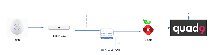

This is the main path. The “fallback” path or secondary DNS is, when the main path fails or is offline is:

  • Separate HV: At the moment I don’t have dedicated hardware to run a standalone hypervisor to have a duplicate of these systems :smiley:
  • Conditional forwarding: Both AD and Pihole typically go offline at the same time, so placing them in different order wouldn’t achieve much. Also, Unifi being the primary DNS (i.e. first in the chain) to consolidate queries.
