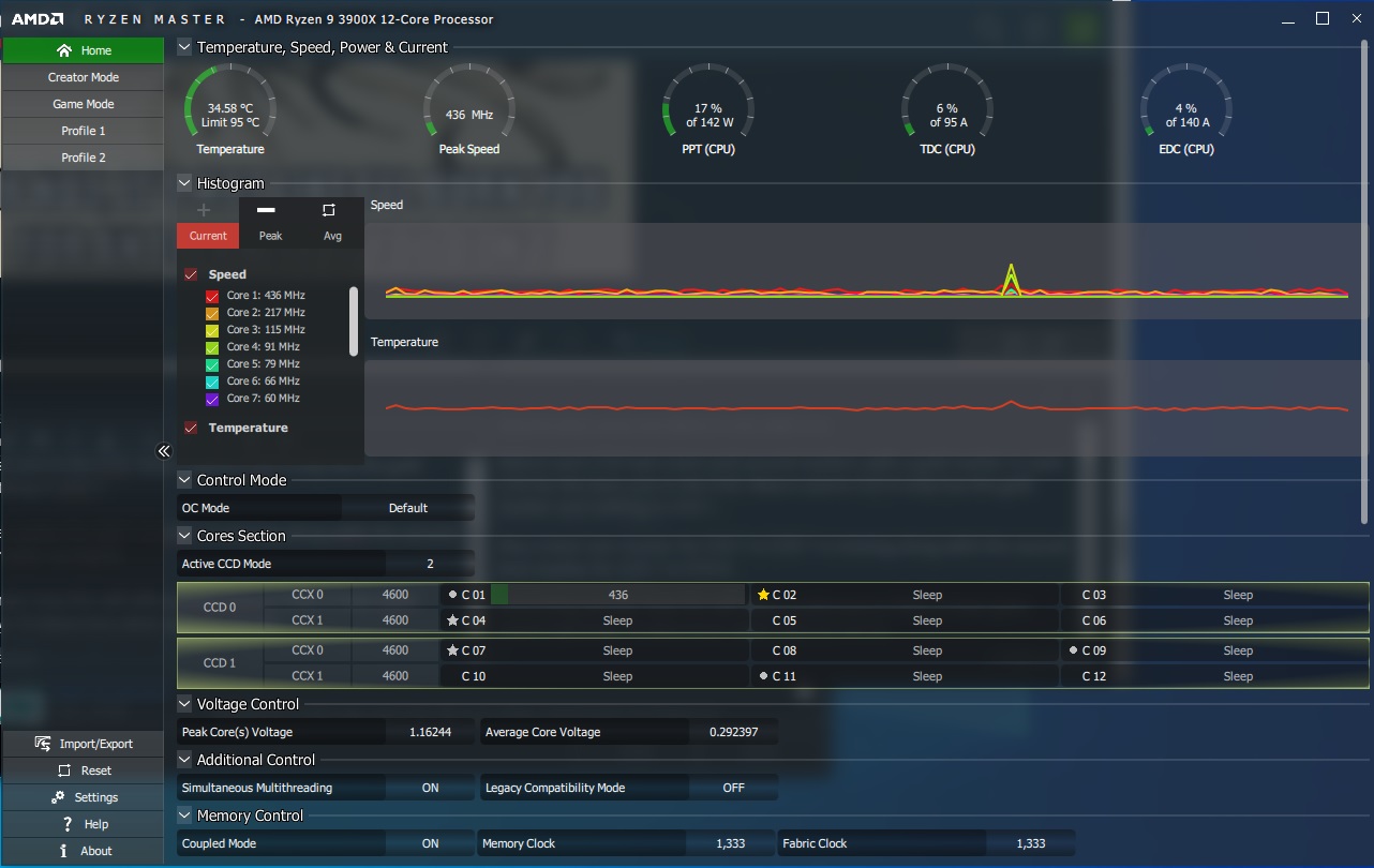

One interesting thing I am noticing is that Ryzen Master is not listing the best, second best cores the same in this new CPU.
Before each CCX had a best and second markers with a gold marker in each CCD for the best core in the CCD. Now it seems CCD 0 only has the gold marker and nothing in CCD 1.
Also a best core marker for CCX 1 in CCD 1 is missing along witht the second best marker for CCX 1 in CCD 0.
Interesting wonder if this is because AMD is trying to crank these CPU’s out (this was the last shipment amazon recived) and I wonder how this will affect performance (if at all) if this is how ryzen master/windows 10 determine what cores to favor.
