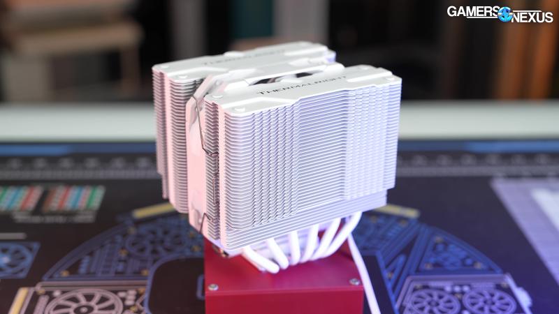

I Belive that the Thermalright Peerless Assassin 120 Mini would fit with the RAM.
@LorenzoVonMatterhorn Oh this looks nice. I wonder if I can mount it 90° and it still fits. I have to try if Front to Back cooling is even needed here.
Would mounting a NF-F12 industrialPPC-3000 PWM to the Thermalright Peerless Assassin Mini help to improve the cooling even more? Noise isn’t a big deal, it should just not sound like a jet engine.

Unfortunately base to top of finstack on the 120 Mini’s 135 mm and then the fan sticks up a few mm past that, so probably ~140 mm. Versus the 130 mm available in U4-4088-S. The Peerless Assassin 90 would fit and might beat NH-U9S on performance (certainly price) but SI-100 might do better than either so far as Thermalright parts go. I don’t know of comparative tests offhand, however.
