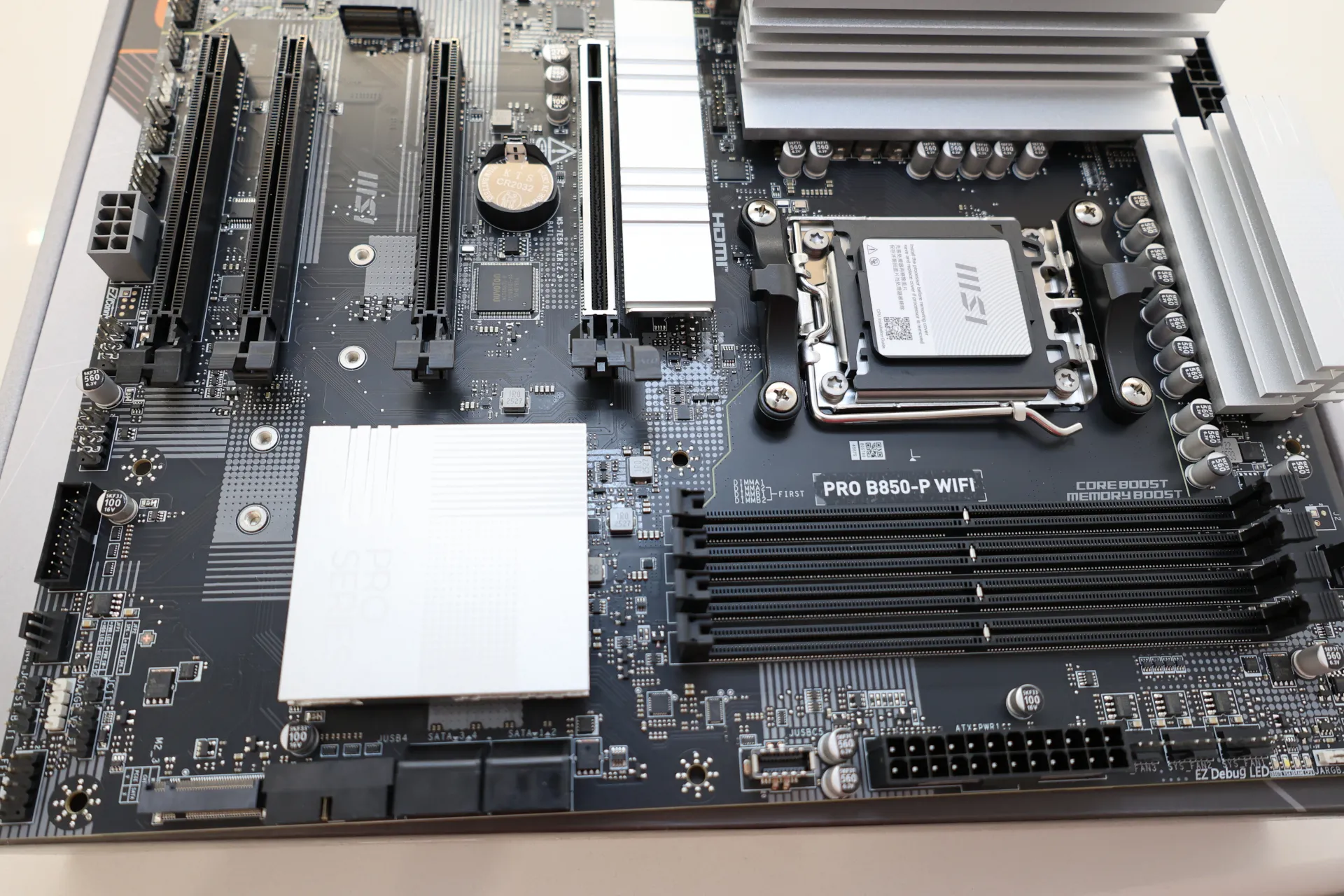

After 3mdeb ported the AMD Turin OpenSIL PoC to the Gigabyte MZ33-AR1, the next plan after vacation season was over was to use the recently released Phoenix PoC to port their Dasharo Coreboot distribution to an AM5 board that is accessible for end users similar to the MSI PRO Z690-A / Z790-P that they did a few years ago.
The initial target was a mATX board, the MSI PRO B850M-A WIFI. Sadly, it seems that it is not globally available cause eRetailers in USA have them yet it doesn’t seem to be available in Europe at all, so there was a change of plans and went instead with the ATX sized MSI PRO B850-P WIFI, which is most likely what is going to be shipped.
So far, it is ONLY intended to support Phoenix based APUs because that is what the PoC is for, unless they decide to risk it and figure out if they can get any of the CPUs to work. That is not impossible cause they had success porting OpenSIL to first generation Ryzen, but with absolutely no vendor support it may not be a good idea.

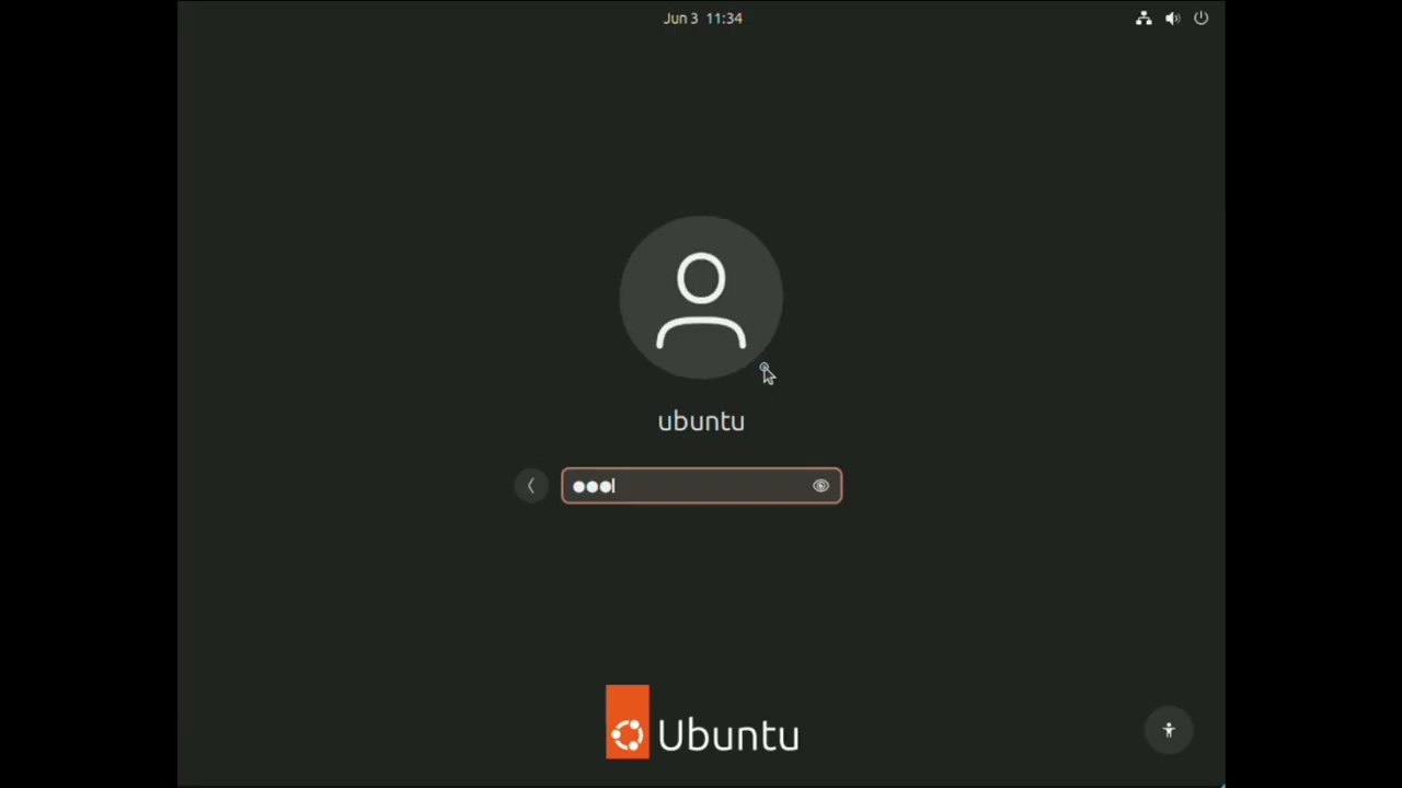

POST but still doesn’t fully boot Linux due to missing PCI stuff, but is getting there. No idea on ETA since they still have to release to public the Gigabyte MZ33-AR1 even though it has been working for months already.

Hmm, the motherboard in one of my current builds (MSI B850 GAMING PLUS WIFI) shares the same MSI board number as the MSI PRO B850-P WIFI they are using. Both show as “MS-7E56”.
Wonder if there’s hope for future support if these boards are closely related.
I like that MSI uses these codes - anyone know why no other manufacturers seem to do this? Or at least, they are not as accessible? In Linux on MSI boards I always see that board number under the “Host” field in Fastfetch instead of the long retail product name.
MSI is weird in the use of internal codes. The LGA 1700 Z690-A (DDR5) and Z690-A DDR4 use the same code, MS-7D25, even though they are NOT the same board, just quite similar (Changes in DDR5 slot type and power delivery for them, but the rest was pretty much the same IIRC). Same with Z790-P (DDR5) and Z790-P DDR4, same internal code, slight differences (Heck, they are almost identical to the Z690-A counterparts compared to each other).
Yes, the B850 GAMING PLUS WIFI came up when discussing if B850-P code was reusable for the other skinned boards. I do recall than when comparing MSI website photos than there was an extra RGB header, but layout seemed identical. They still wanted to check it themselves before announcing support, and due to extra hardware and validation costs didn’t picked it earlier.

Now booting Windows 11.
