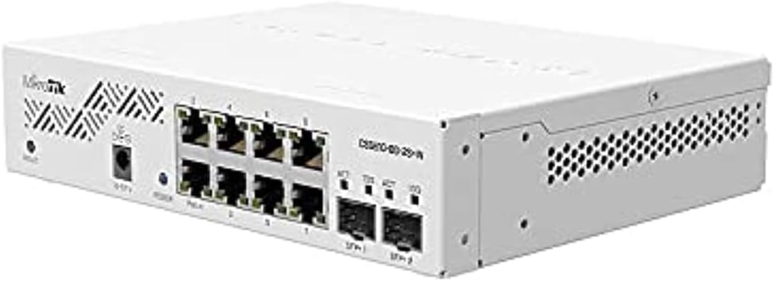

Yes the investment in fibre is expensive but I rather be able to just upgrade the ends rather than have to chase new cables in the future. But you don’t need media converters if you use a switch to break out to Ethernet. I my case, I have at least four machines in each room that need to be hardwired.
One of these more than covers the cost of four media converts plus allows more connectivity in the future.
