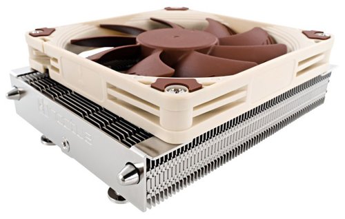

Noctua has some really great low profile stuff IIRC.
I have not found anything in the BIOS to control the processor's speen or energy consumption. I did however find power settings in Windows 7 to set the processor's maximum state to 60%. I am pretty sure 60% of an X5460 is still powerful enough. Now, I just have to run the system for a while and see how well this bad boy runs.
It's still running in the 40's and the low 50's, but if it doesn't exceed that, I guess it's OK. I'd still like it a little cooler. HW Monitor still shows it running at 3.16GHz, but the temps are a little more stable and it's a lot less noisy!
I would like to power it back to full-throttle, but finding a cooling solution that fits in the case and doesn't have clearance issues with the case or the memory is going to be a trick.

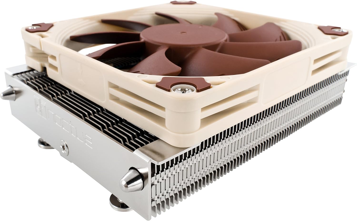

Have one of their low profile coolers in my computer, works amazing
Noctua?
Ya this one
Is that fan Intel compatible? Will it work on a processor with a 120W TDP? It's not a bad price, so if the answers are "yes", it's totally worth getting!
