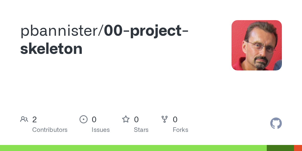

Bit spooky. Working project skeleton is here:
