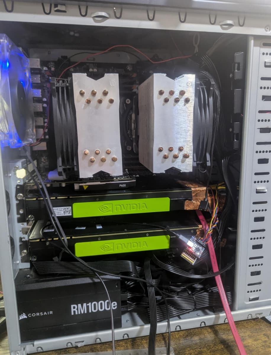

My 24gb Tesla M40s just have dell blower server fans held on with copper tape, i had plans and designs to 3d print and mount but its only for me to play with so tape is good enough. rest of the pc is 2x 2699v3 18 core xeons, cheap dual socket dual channel x99 board, 1000w power supply and 128gb ram. the fans are controlled by the esp32 c3 board, the plan was to use a pair of i2c temperature sensors on the back side of the cards but because i didn’t have the sensors in at the time i just set a decent fan speed and left it and it ran fine, it wasnt quiet at idle but that didnt really matter and i still havent got around to fitting the sensors as it was good enough.

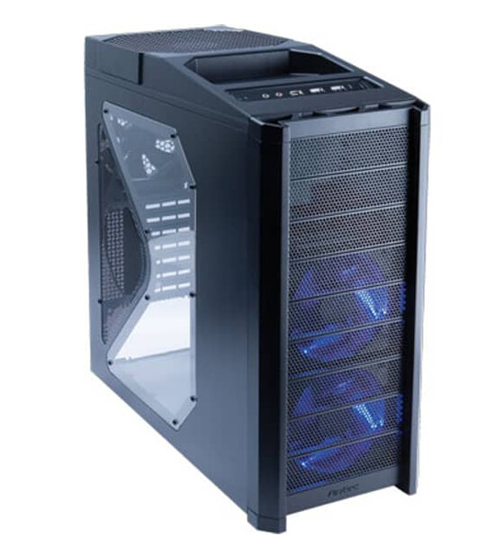

the case is a vintage Antec 900 Nine Hundred
I was about to say, look at that steely!
Also, exactly how an ESP32 should work, hanging in the air with wires

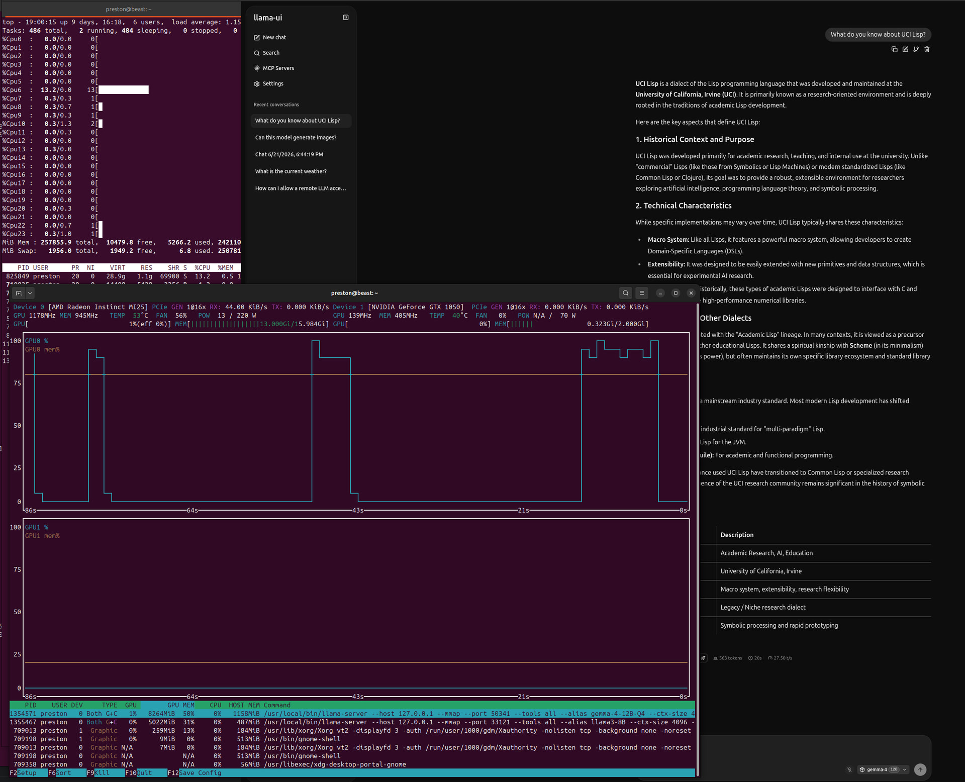

Turns out, getting an LLM running using the Vulcan backend is easy. So the excursion trying to use ROCm to run LLMs seems a waste.
Rebuilt llama.cpp to use Vulcan, and can run LLMs on the GPU.
No notion if these numbers are any good. :slight_smile:
During the tests, card temperatures stayed below 80°C.
Belatedly realized that Vulcan is using both the MI25, and the NVIDIA GeForce GTX 1050 (meant only for display).
GPT-OSS is odd, as it runs the 1050 flat out, while the MI25 is loafing.

Turns out, I can force Vulcan to use only the MI25, and the numbers improve.
$ GGML_VK_VISIBLE_DEVICES=1 bash download-mi25-models.sh

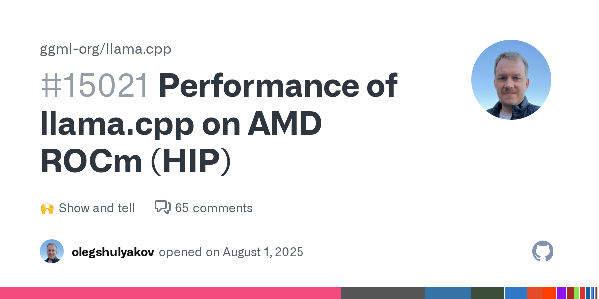

Should note, posted on llama.cpp thread, and got some interesting response. To summarize:
  • For LLMs, ROCm should give better performance than Vulcan.
  • The ArchLinux build of ROCm kept gfx900 support.
  • ROCm 7.13 re-adds gfx900 support(!!).
  • The “turboquant” builds of llama.cpp can improve performance.
Seems there is another episode to this exercise…
