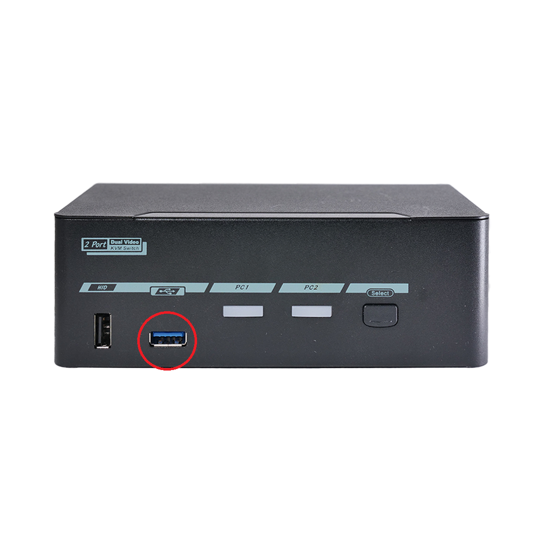

Are you accidentally triggering the switching with with your keyboard?
Plug the keyboard into the blue USB3 port to disable hotkeys and see if the switching behavior persists.

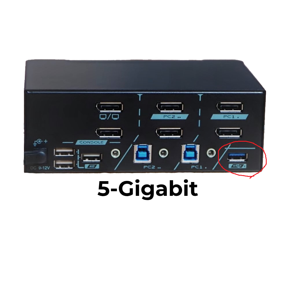

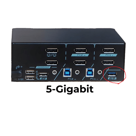

The only USB ports I’m using are the two blue USB 3.0 ports. The one on the front left and the on back right.
Front is Mouse, Back is Keyboard.
