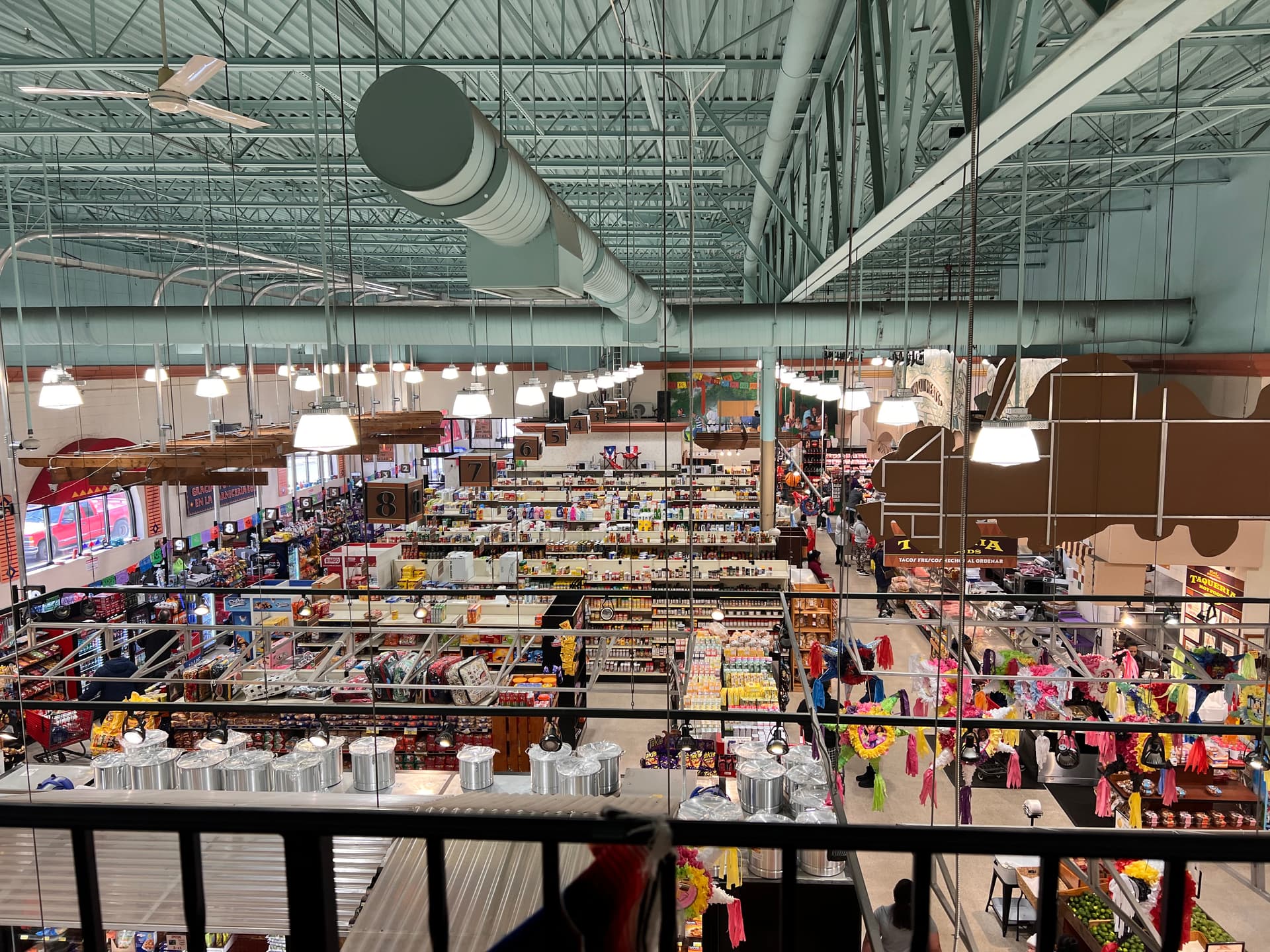

The goal is to give a somewhat seamless connection across these APs which I know can be device dependent in a lot of cases. Attached is a picture from the upstairs on a balcony. I wanted to have 1x AP here, and another on the opposite side of the store above the front office seen below. This is approximately 150’ away and both will be hardwired. I can run another wire to the center of the store for another one if needed. We would then have 1x AP in the back hall, centered and another upstairs, also centered.

An important factor is the mounting location and direction the AP is pointing. Where you took the picture from looks like a good height to mount these at, pointing acros and slightly down towards the ground floor. Mounting the E7 Camput on the ceiling pointing straight down would not be a good application for them. The E7 Campus has directional antennas, not omni ones like ceiling APs have. Also be aware these are powered by PoE++ and use 45w of power each. You will want a switch with large power capacity for deploying these. Id recommend the Pro XG 10G that is about to release:
