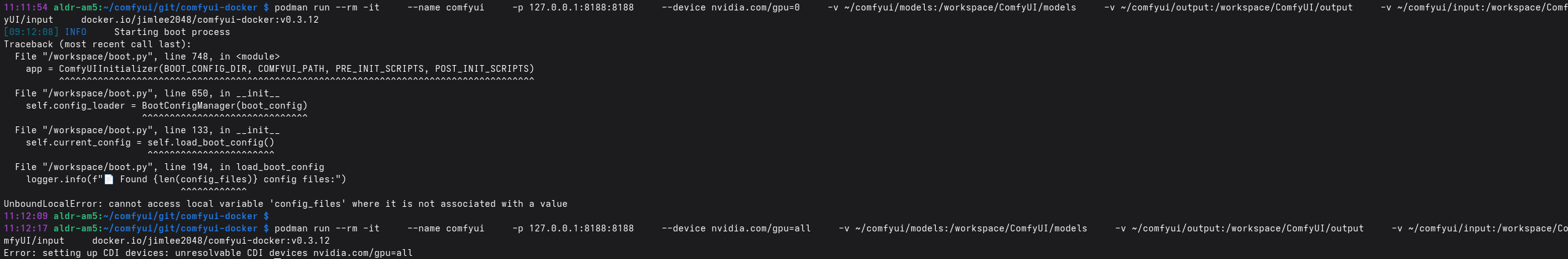

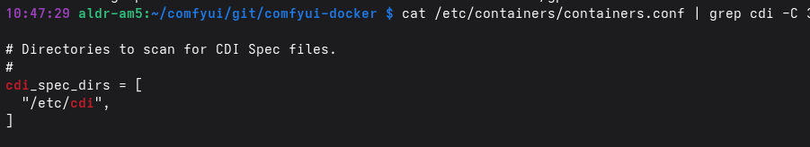

I explicitly told podman where to find cdi files and the .yaml is also present in that folder.
My GPU has three entries:
So I would assume when calling the same command with each device name--device nvidia.com/gpu=all, --device nvidia.com/gpu=0 and --device nvidia.com/gpu=GPU-1f96442d-8fbe-e6e4-1604-c0bfb8f96cd6 that I would get the same result. But if I use the UUID and all option I get another error than if I use 0
so with UUID and all I get a Error: setting up CDI devices: unresolvable CDI devices nvidia.com/gpu=... but with 0 I get a Python Stack Trace for some Config not found?!?
