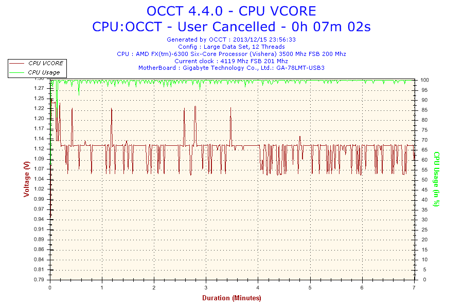

I've also notice this throttle is often accompanied by a voltage drop. The higher my overclock, the worse it gets. I've tried compensating with LLC, but I really don't have any control of it – there is AUTO, Normal, Extreme. Auto and normal don't do anything, and extreme doesn't really prevent the issue (though I notice less frequently), but I get massive voltage spikes (as high as 1.38v from 1.25, already upped from stock 1.15v). I should also note the voltage drops have been equally extreme, as low as 1.00V.

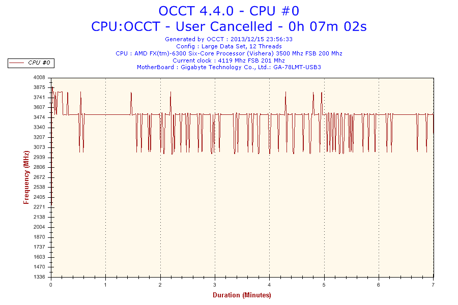

Here is a run of OCCT:
Frequency:
Voltage:

Set the LLC to Extreme for gigabtie mobos as for the GA-78LMT-USB3 its a nice starting point mobo for a standard computer its not for heavy use or overclocking its a rehash of a very old AM3 motherboard to take new AM3+ cpu's and it only has a 4+1 power phase.
Well, my main concern with that is the voltage spikes, which are well beyond the spec I set. I'm not really aiming for a heavy OC, if I can get 4.2GHz base, I'd be happy, which I'd expect is completely reasonable given the FXs can get 4.8GHz fairly easily with good air cooling. I'm hoping the mobo is up to snuff since it should be using some quality VRM components (UltraDurable, right?), and it does have cooling, and it does support 125W TDP.
I guess I really shouldn't be too concerned with voltage spikes given the reviews I've read seem to indicate that the FX CPU's beg for more voltage and better cooling.
Nope like i just sead that motherboard is NOT for overclocking technically isent even a AM3+ motherboard its a old motherboard that was originally intended for AM3 chips and thay just slaped on a cuple of usb 3.0 ports and gave it a new bios.
agree  im totaly not a fan of gigabyte am3+ boards in general. But those lower end boards are just totaly not made for overclocking at all. the 4+1 powerphase and analog vrm´s  its just lack.
For an FX6300 i allways recommend a Asus M5A97 R2.0 board as an entry level board.
