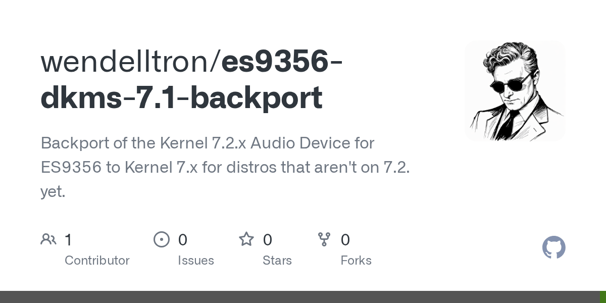

Backports?
The LTS kernel (6.18.40) does not have the FUNC_NUM_* function-number macros or SDCA_SINGLE_Q78_TLV that the es9356 driver depends on. These are 7.x-era additions to the SDCA headers. So the es9356 driver cannot compile against LTS headers without backporting the SDCA header macros too
I can do a working dkms for 7.x kernels. How about that?
Even then, the LTS sdw-utils has a different struct layout and no runtime machine-selection path… that’s not good. TODO more later.
