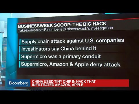

Here is an interview with one of the reporters, Jordan Robertson:

At 5:44 in the video I linked above, the reporter responds to why they are confident in their report saying that in contrast to company comments from Amazon, Apple, and Supermicro:
We have voluminous reporting on the other side from 17 total sources; including inside those companies: Apple, Amazon, and others; and extensively within the US Government that this attack did indeed occur.
He then mentions two reasons why companies would “deny this reporting”:
  • “This is an ongoing highly classified, top-secret US Government investigation”
  • “There was no consumer data that’s alleged to have been stolen” so companies are not required to disclose
