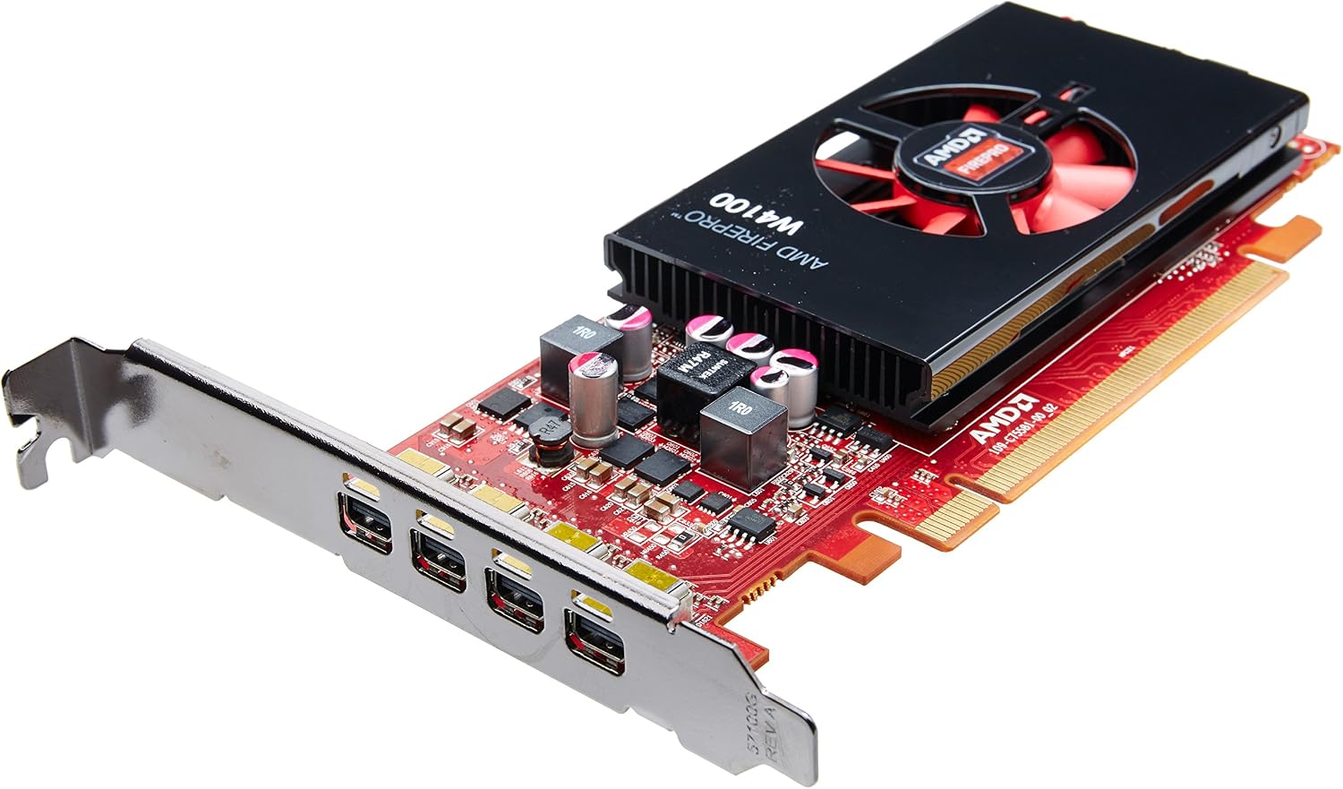

OK, that Firepro W4100 for 130€ actually seemed to be the cheapest option (until @Cavemanthe0ne's last post ), given that a used R9 290 was the cheapest card with the confirmed ability to run 4 monitors simultaneously at least to my knowledge until now. Still, 130€ is pretty high for what I'm going to use it for :/
I've found some GPRO 4200 for around 150€ new, so the same goes for them. And yes, I was already waiting for the Matrox-joke :D
