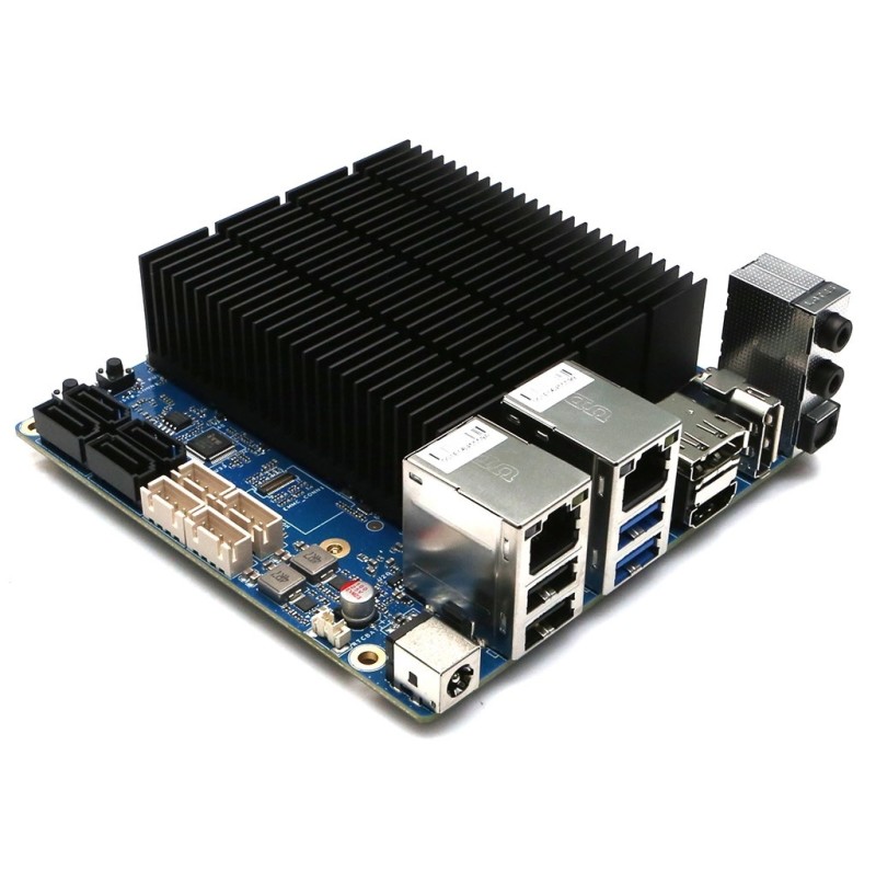

Odroid H4 Plus which also provides some kind of aftermarket support?
https://www.kubii.com/fr/boitiers-ventiles-intelligents/4309-2059-boitier-officiel-pour-odroid-h4-3272496318656.html or Type 4 (Type 4 might need longer cables, see ODROID-H4 Case Type 4 – ODROID)

That’s an option I hadn’t considered, Thanks !

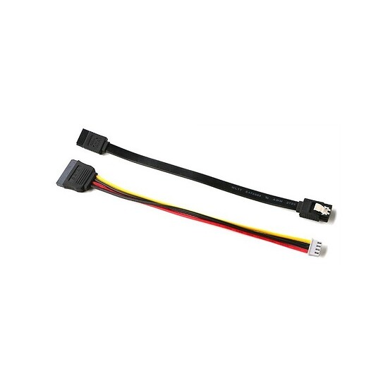

Though with the sata power cables and the power supply I’m already close to the budget, and I would still need at 2.5G switch to plug the 3 nodes of the cluster plus this board. But I do like the form factor :slight_smile:

I made additional research on the odroid H4+ and, the prices on their website are more in line with my budget. And I discovered their Net Card
You were right, all in all it makes for a very compelling package, thanks !

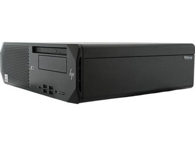

If you want any proper NAS on a budget, snag a workstation with a xeon and ECC UDIMM memory. Slam in the same M.2’s in adapter cards and boot off SATA. This will DESTROY your budget though.
my latest workstation buy was:
