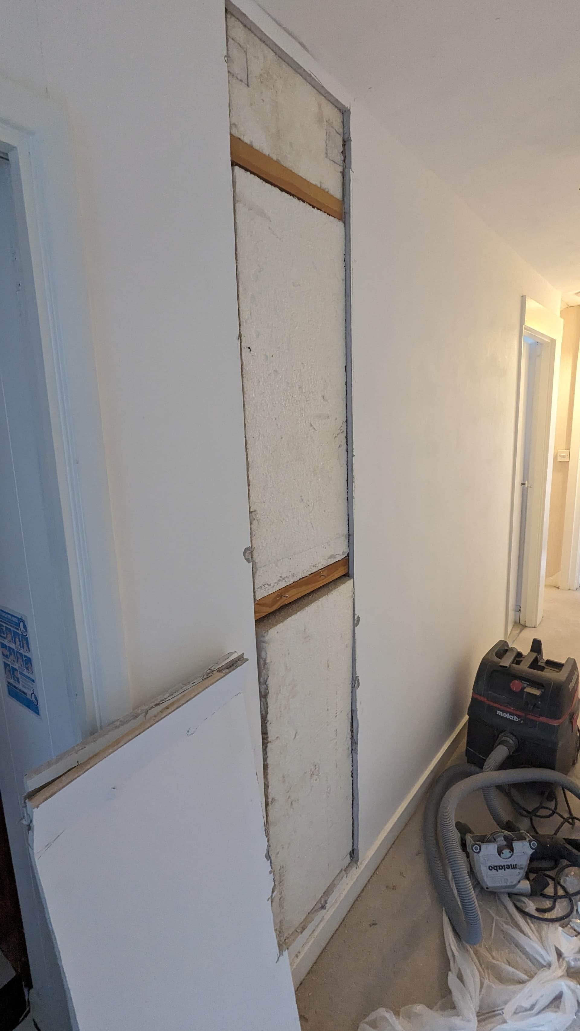

The fun of no old building being straight forward. So making a room larger by sacrificing a toilet. Cut some board to check stud arrangement.
Cut the board away

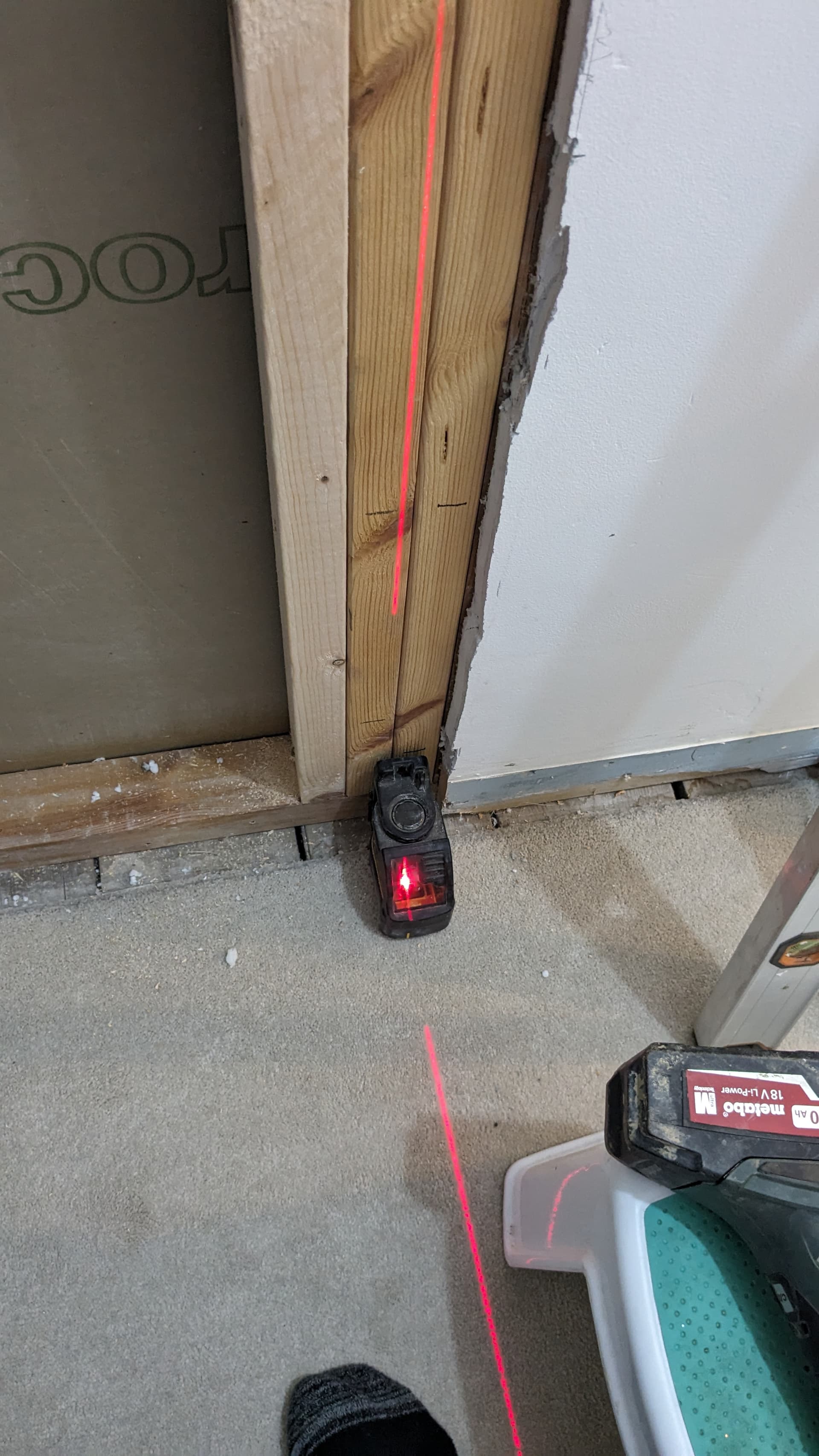

remove poly insulation and cut some new pieces to support the new door and wall, and another piece to support the replacement plasterboard
getting a good perp line

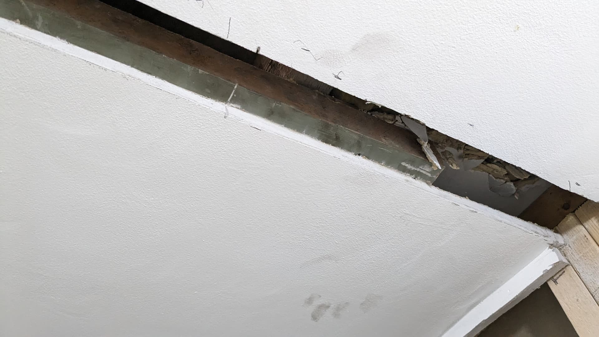

cut the ceiling out ready for the header

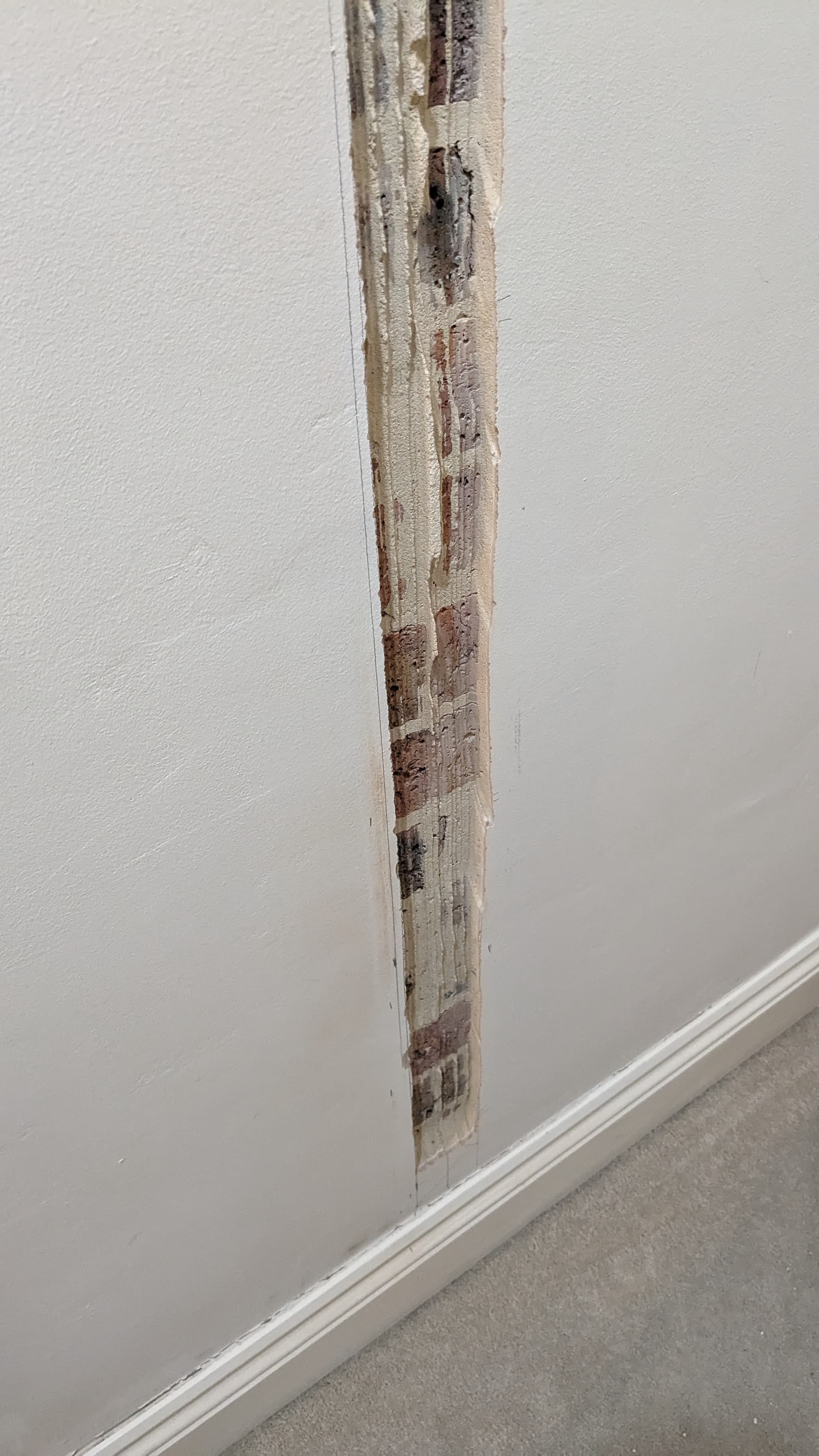

other wall is masonry with solid plaster (not board), set out chase
set depth and started chasing, will have to finish off top of bottom by hand
back to head, the visible board is false and attached to short timbers that’s then attached to the under side of the true joists

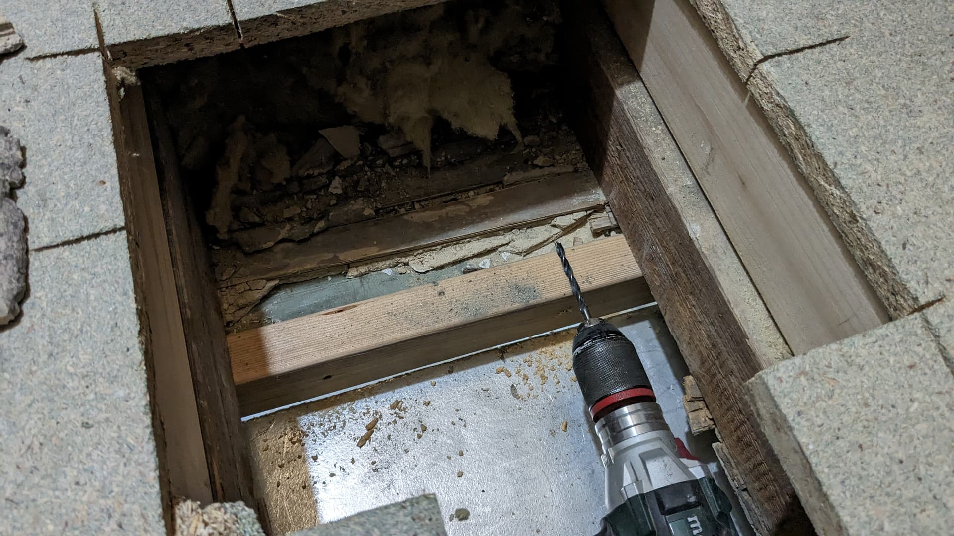

sods law but that piece of timber isn’t wide enough for fixing the new header timber as it needs fixing to something solid. got access from the loft space, this gave access to the original plaster under the original joists. cleared it away ready to take a new timber length
(this is looking from loft, down - what’s more fun is that the original joists have counter timbers over them, probably to allow boarding out of loft where pipes were in the way.
only if this is vaguely interesting, I’ll keep posting :slight_smile:
fitted new timber next to existing and 6 inch screws attached to real joists
Didn’t have faith it wouldn’t separate, so drilled screw hole for additional screwing to existing cross batten
had to cut a bigger hole to get impact driver and drill in

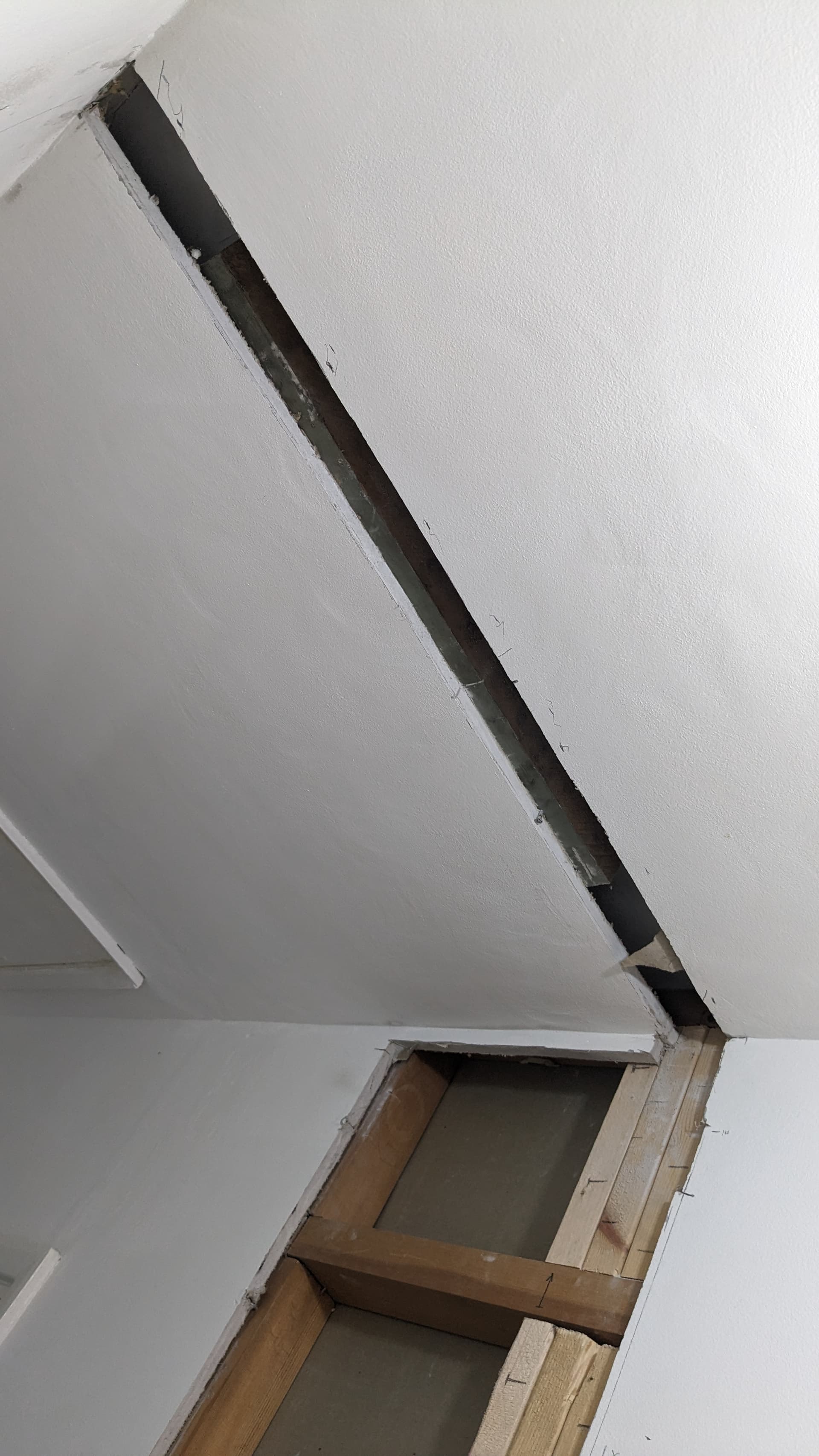

header is on, ceiling is so on the p**s so had to pack it
Not much progress, masonry wall was a pig getting the masonry screws to bite
