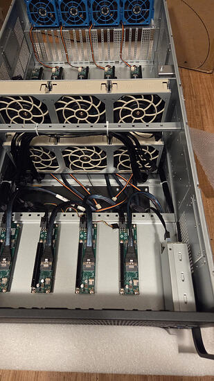

Alibaba has many options:
I just ordered another TP8 chassis for my next build.
