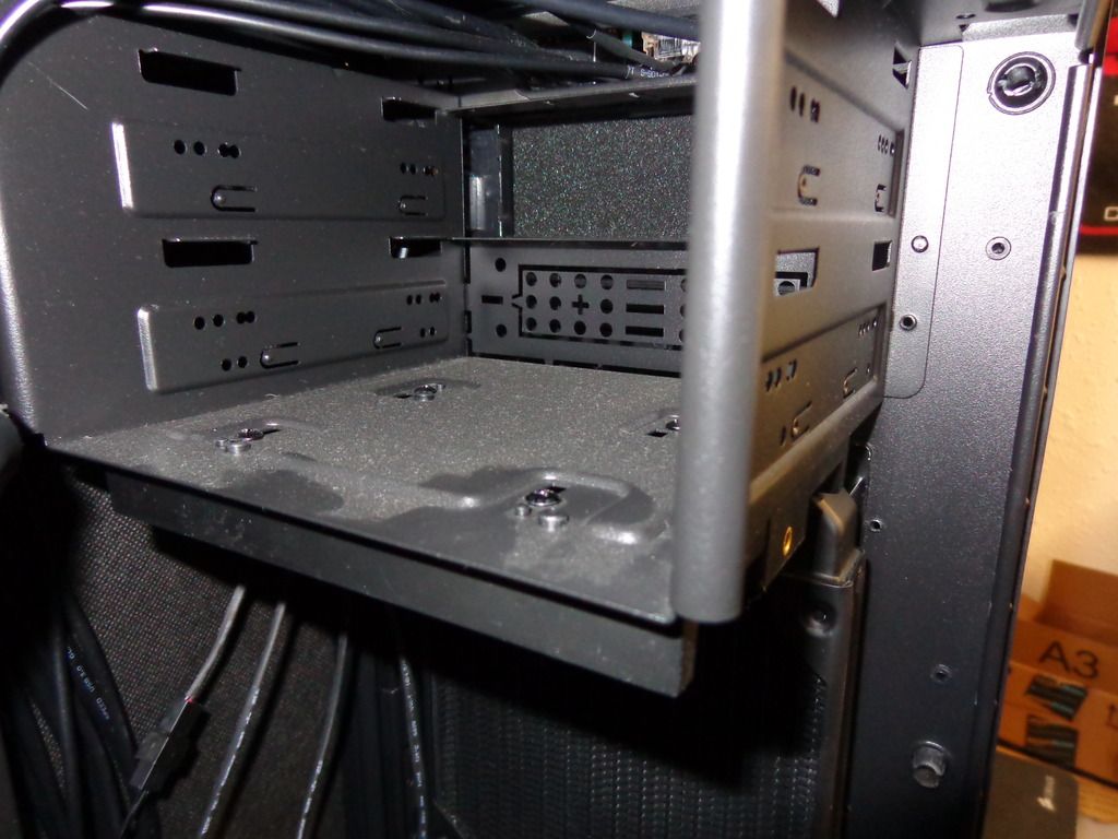

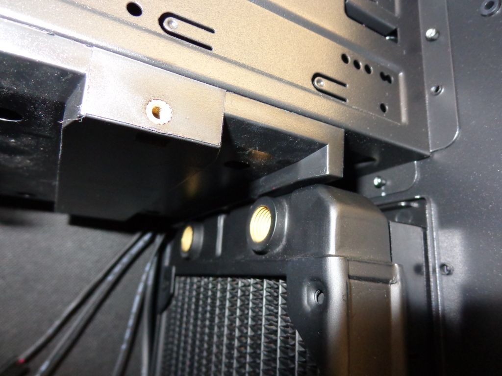

Sorry it took me so long to upload this even though I took the photos like a week ago.
Here is the long story short: Will it fit? Yes. Will it mount properly as designed be NZXT or Fractal Design? No. You can use it, but you will have to remove the hard drive cages and also the top plastic cage bracket which takes a little effort because you need to be able to get a philips screwdriver into the 5.25" drive bays on top. This will require some sort of specialty screwdriver. In my case I used a 1/4" ratchet and 1/4" socket and a standard PH2 aka #2 philips bit.
Radiator touching top and bottom of the case causing fan holes to not line up or create any sort of airseal:
Drive cage bracket interference:
