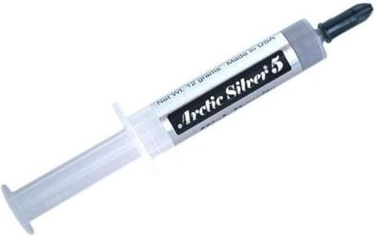

As said above they’re pretty much the same in terms of performance, since you need more than normal you probably want to for AS5 if you have price/performance in mind.

not really mate. arctic mx-4 or tuniq tx-4 will do the job, but don’t need heat cycling or 200 hours to cure. which is the drawback of arctic silver 5.
Which isn’t an issue and also mentioned in the application instructions…
ok… then it costs more and isnt as good…
and yes im trying to dissuade him from as5… it was good 10 years ago…
its very much average now and relatively expensive compared to others.
Yep, like other’s have already said 1-2C difference is a lot…
it can be if your cooler isnt the best…
but seriously… as5 was decent back in the day, but things have moved on.
like i said my main gripe is during the 200 hour cure, your gonna be looking at 5+ c difference between application and completed cycling.
then after 18-24 months you gotta clean it off coz its gone gritty and starts loosing thermal conductivity.
the more modern pastes dont have these issues.
