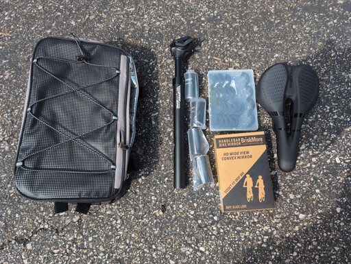

Today’s haul:
  • Insulated trunk bag
  • (cheap) suspension seatpost
  • rockbros saddle (perineum hole!)
  • bag o’ rubber shimmers (NOT PLASTIC)
  • bar-end mirrors
The bar-end mirrors must wait on my new grips, which coincidentally, have no throttle. That’s right, I’m anti-throttle! (not really, I just don’t want to be using it)

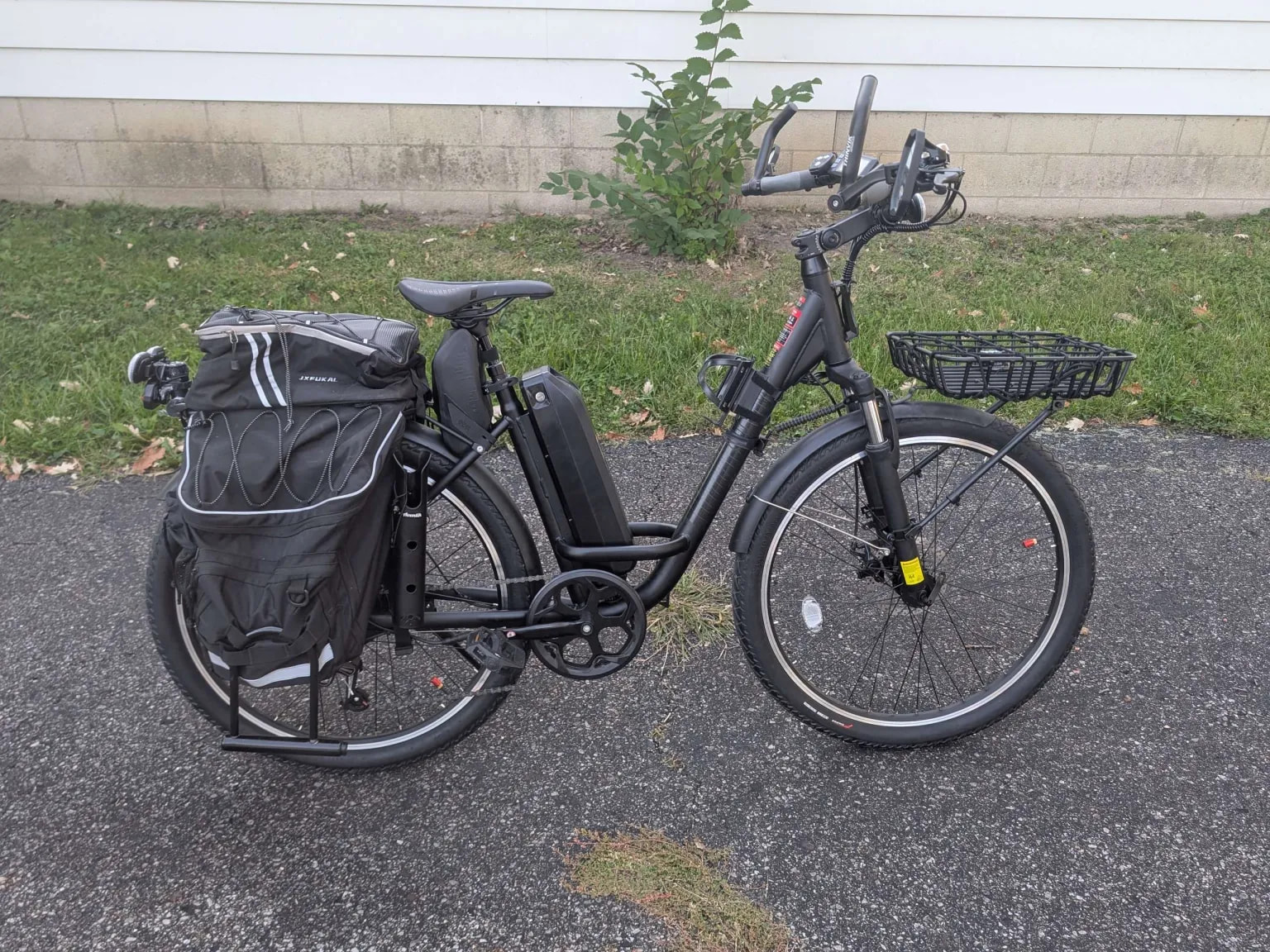

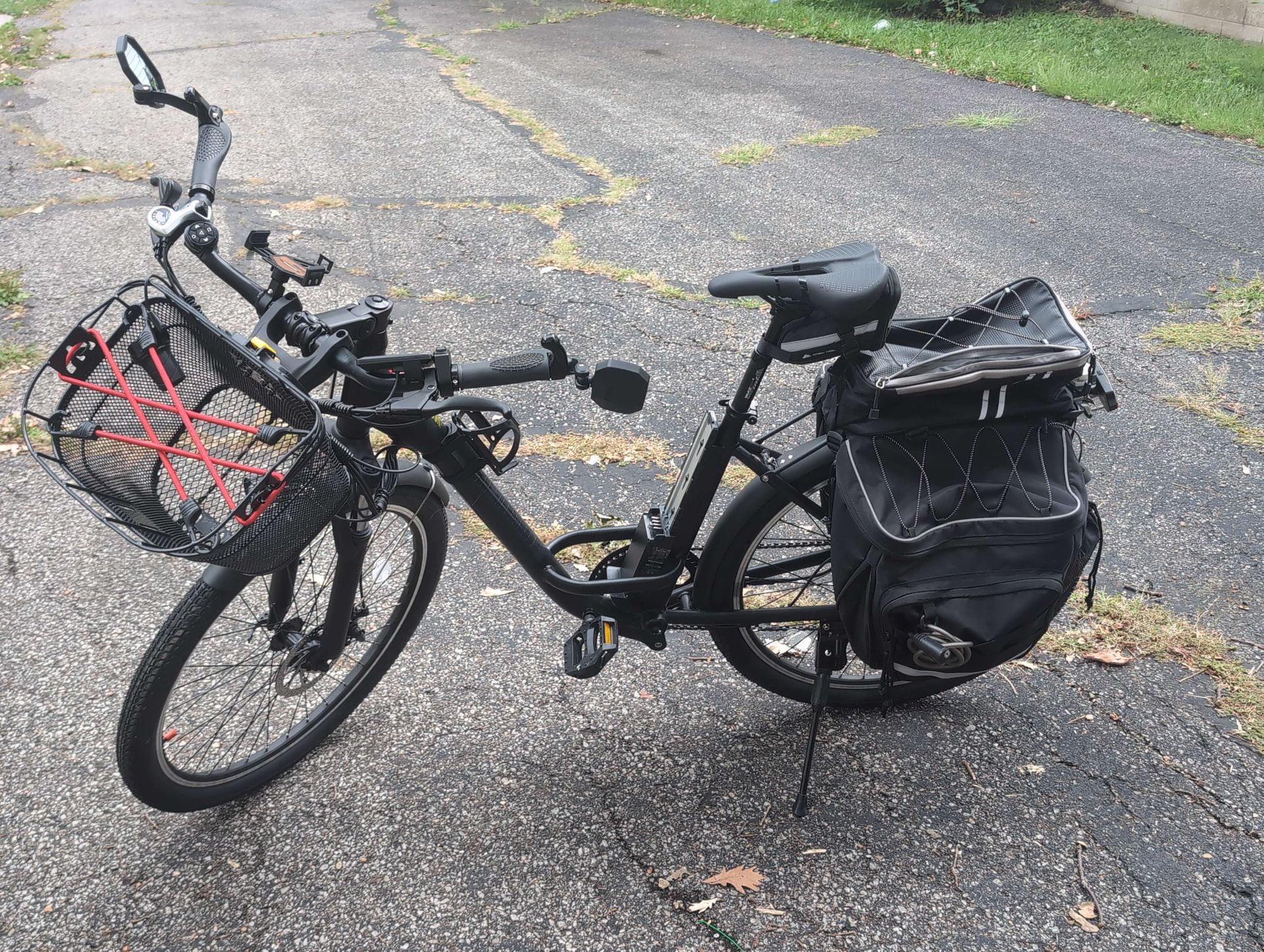

Here’s the current state of the Funhang.
Current upgrades:
  • Universal (cheapo) bottle cage (actually pretty decent)
  • 50L Panniers
  • 12L insulated trunk bag
  • Front basket (newly equipped with bungees!)
  • Rockbros saddle
  • CYSKY suspension seatpost
  • Rockbros phone mount w/ quick-release
  • Media controller
Temporarily removed/not yet installed:
  • Rear turn signals / brake light (hinge broke. Luckily I won’t need that part soon, according to the plan)
In-the-mail:
  • Rear light rack-mount (hoping it fits right)
  • Grips (rockbros again)
  • MIPS helmet with a photochromic visor. (Fancy!)

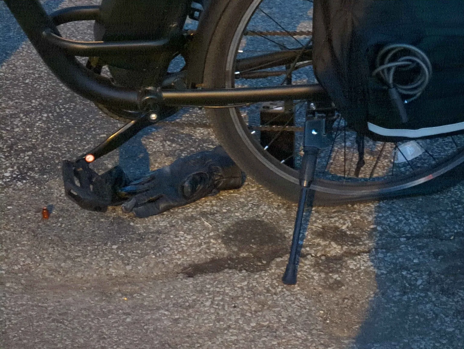

Flat today several miles from home. Less than pleased.

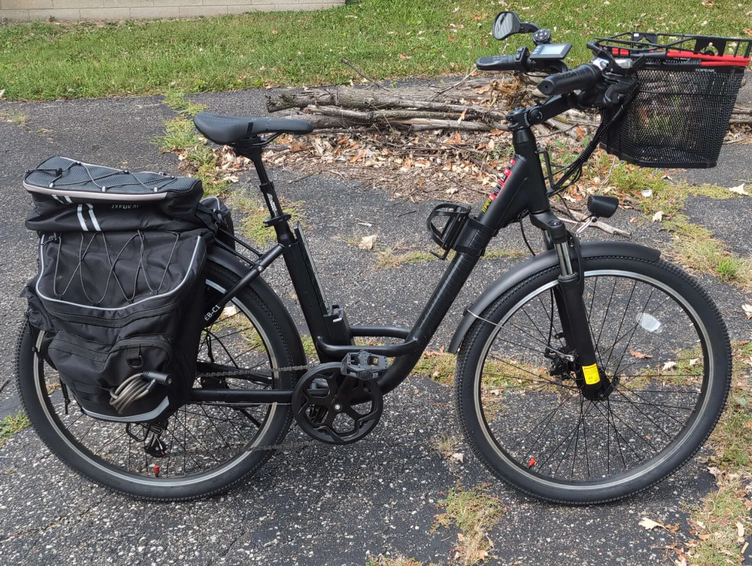

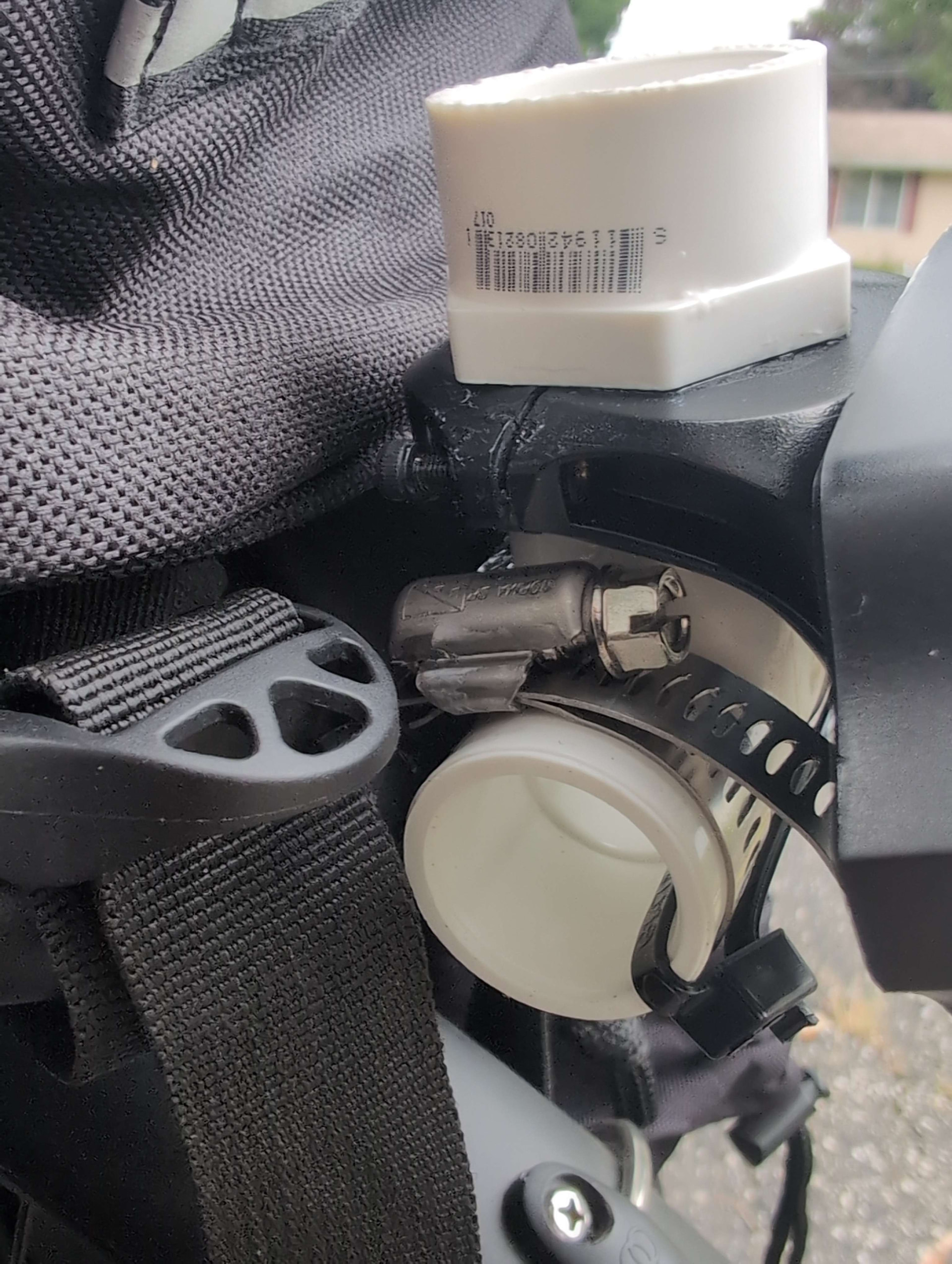

Big update today! Not only are the tires & tubes now non-stock both front & rear, I’ve now installed the new grips, mirrors, and my hacky solution for the current (temporary) rear light system. That last allowed me to move the tool pouch to where it actually belongs.
The funhang in all of it’s current ‘glory’:

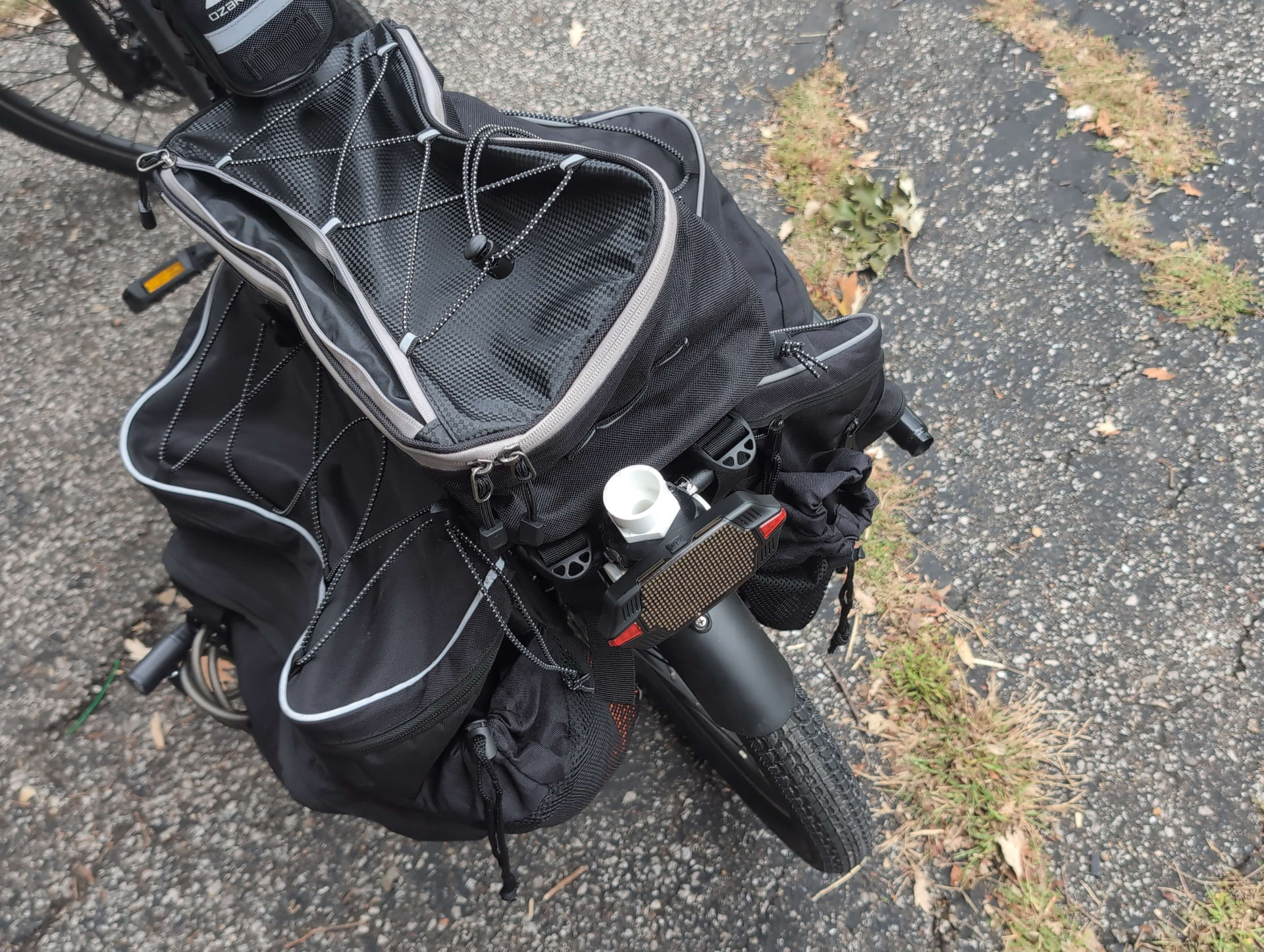

The hack:
As you can see, the light is absolutely intended to mount to seatpost, but that’s not going to work, so here’s hoping that this version stays vertical (and if it doesn’t, I have a few ideas involving more zip ties).

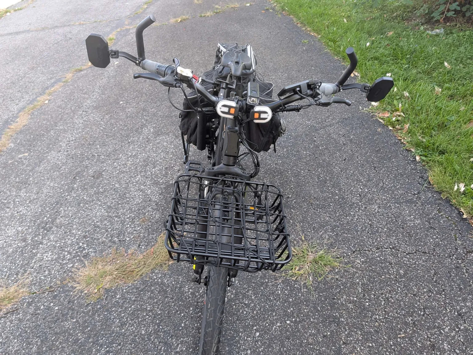

What do you think of everything thus far?
I am quite happy with my recent upgrades.
  • The little bar-end horns are really lovely for sitting up and back on long flat straights.
  • The bar-end mirrors are out of the way and still quite useful.
  • Having the turn signal is so much less of a bother than hand signals.

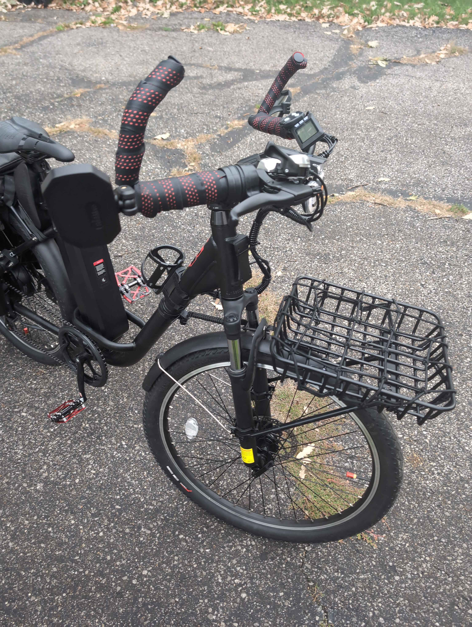

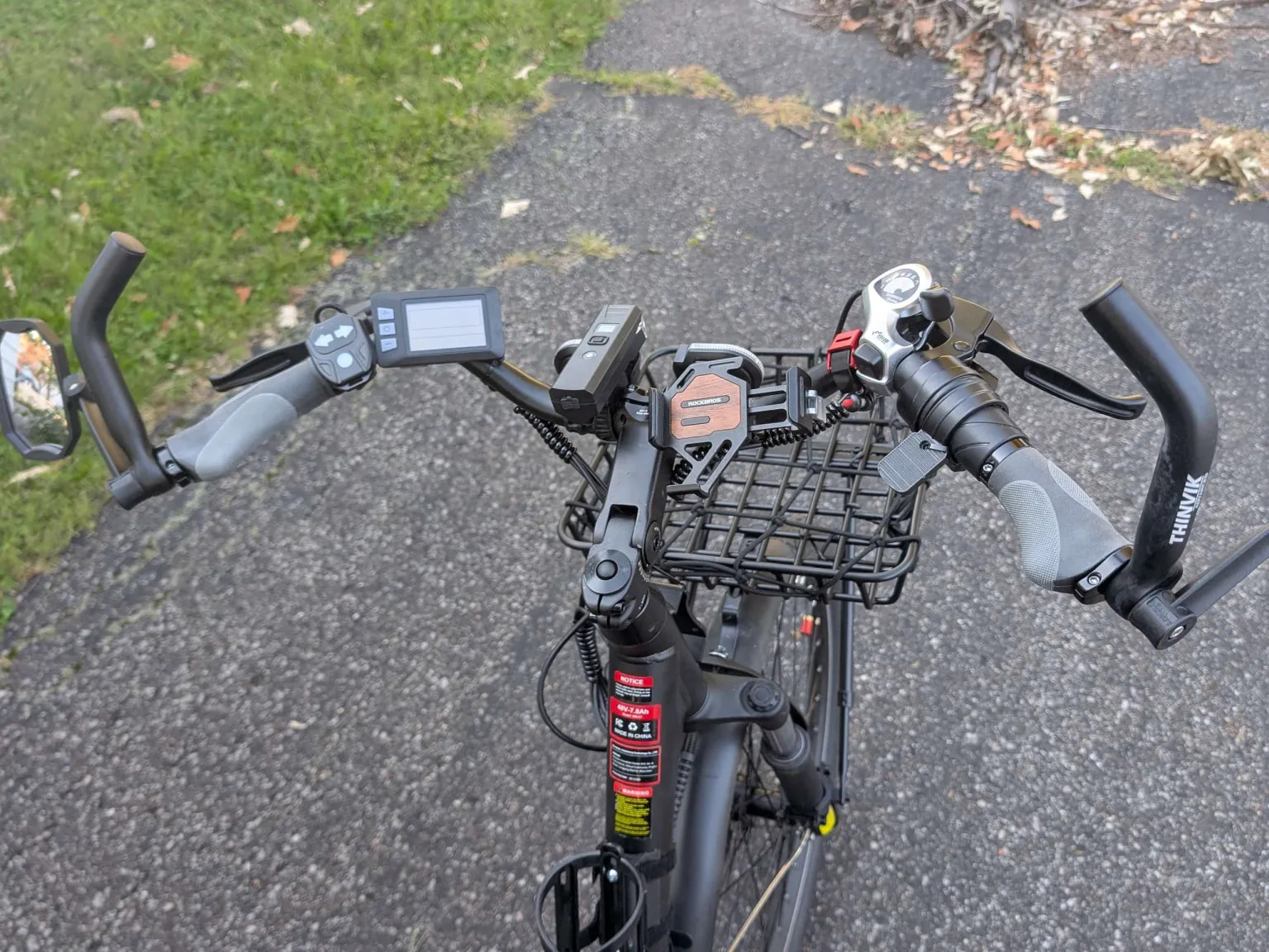

Well. This has definitely been neglected for a minute! Now, I’m near to 200 miles on the bike, according to it’s display, at this point.
Replaced, fixed, upgraded & otherwise work done:
  • Painted the janky DIY brake light mount
  • Grips (I was happy with these but)
  • The throttle has come back. Yeah, sad, but traffic realities: on occasion I’m (somehow) first at the red lights.
  • Bar End Grips
  • Nifty grip tape (not installed the best, but should be fine)
  • Front Basket was replaced with a shallow one for better utility
  • New front basket geometry was bad, so added deflopilator
  • Deflopilator wasn’t enough, so reinstalled the new front basket “wrong” in order to bring it back and down toward fender
  • Pedals were upgraded
  • Independent headlight (stock one suuuucked)
  • Bell, since stock bell was on the same handlebar doodad that had headlight control
  • Front & Rear turn signals
  • Saddlebag tool bag was upgraded
  • Added a fishing pole holder
I’m actually planning very little more on this bike right now, except for a DIY skirt guard so I can ride wearing my trench coat in fall and not worry about it. After that, if nothing breaks / causes issues, the next thing will probably be some sort of grip mitten sock thing for winter riding. I might add a 2nd strapped bottle cage, but that’s cheap enough to be amost nothing. Beyond that… well, if the suspension seatpost doesn’t soften up more, I may look for a better one on sale.
I have also decided not to do a battery upgrade or try to integrate the lights into the harness, or try to add bottle cage rivnuts to the main/down tube. I’m just not interested in the amount of bike downtime it would probably take to document the wiring diagram and figure out the controller’s capabilities or lack thereof, or to pull the harness out so I can have assurance that it’s safe to install rivnuts: it’s a better use of my time to hunt for a solid used non-e bike to convert, I think.
After that bike is converted to an equivalent or better ebike, then I’ll sell the Funhang or give it to Kaylee, if she wants it. Remember, never own more than one bike.
The new helmet has been quite nice but I am thinking about replacing it with a dual sport, because I suspect stuffing an air filter in one of those will have an even better effect on the exhaust problem.
I’m also aware that my “cockpit” area is quite crowded. Oh well. It’s gonna stay that way.
