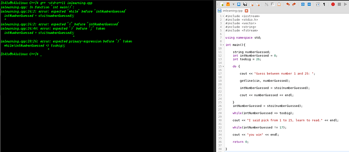

I’m very new to coding and i’ve been trying to figure this out for about an hour now, this is a program I made for practice, it asks you to pick a number between 1-25, I tried adding a statement if the user picks a number over 25 and I have no clue why it doesnt work. help would be much appreciated ![]()

Looks like you mixed up =>, should be >= (line 28)
line 26. cant go there if i remember. move it after the loop or remove it.
line 32&34, while its not 17 print "you win" is that what you want it to do?
The second while loops looks like its causing an infinite loop if things don't go right.
But yeah do a pastepin so we can see/edit it easier
Good point, both second and third while loops are infinite unless the conditions are already true when it enters either of the loops (once the code works)
To add. I assume you are planning on using all those includes? If not and your program is only going to do what you described, you dont need any of them except that iostream one.
The first error the compiler describes on line 26 tells you that you did not follow the convention of a do-while loop. do-while loops must always have the following format:
do {
/* loop code here… */
} while(/* loop conditions here… */);
In other words, you must place the ‘while’ part right after finishing the ‘do’ portion. Remove line 26 and the first four errors should vanish.
@Eden already pointed out that that when describing ‘greater than or equal to’ or ‘less than or equal to’ comparisons like in line 28, you must have the ‘greater than’ or ‘less than’ symbol before the equal symbol.
Also you should check both the upper and lower bound of the guess range when displaying your message.
I have thrown together a corrected and annotated version of your file here (http://hastebin.com/nefuhatalo.cpp). Even though it will now compile and check both upper and lower bounds of input, there are still some things you may wish to still fix (one such thing would be when a user enters input that is not an integer, the program crashes...).
