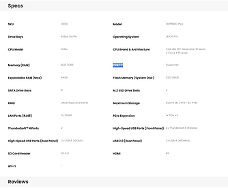

I have a 5600X NAS build already but ECC support is finicky at best. I had to send the board and cpu and RAM to Wendell to get it to work and even then, it is not guaranteed to work. Id prefer either the Epyc 4004 (AM5) or 7000/8000/9000 builds. Not certain the ugreen supports ECC. They don’t mention it and the i5-1235u CPU in it says no ECC support on Intel Ark.
They do, at least on this model, https://www.ugreen.com/products/ugreen-nasync-dxp8800-plus-nas-storage(I would obviously confirm with them to be 100%)
Very odd that you’ve had ECC issues though I do know some vendors can be more flaky than others. So far my ASUS b450-f has worked with the unbuffered ECC that I have.
That is not ECC RAM. that is On-Die ECC. Not the same as UDIMM ECC or RDIMM ECC. On-Die ECC is not the same as Side-band ECC. ODECC is required on all DDR5 RAM modules.
