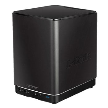

My budget is small (Around £200) But this wouldn’t include the cost of the HDDs/SSDs these will be separate.
So you think a cheap NAS would be the way to go
Although Im up for creating my own storage server if you think I would benefit from this.

Although I have to say: The Ready-to-go NAS boxes are fine. I could play around with a 4 bay and a 2 bay synology. They are fast enough for most things (Plex is probably going to be too much if you transcode on the fly, simple HD streaming is fine though). And their remote access procedure is really nice and painless.
Although the solution with a used PC is better expandable, I would recommend a ready to go NAS if you actually have a budget and do not need stuff like "Oh I want to host small VMs and stuff".
