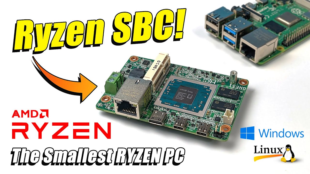

That is a neat unit. Also I know you want ARM but check this guy out.
Where did you find it for $209?
I know the GHF51, saw it on Novaspirit Tech (is that the video?), but I’m more into ARM. If I’m going to x86, I’ll probably get something with a lot of expansion, or a NUC-style PC.
