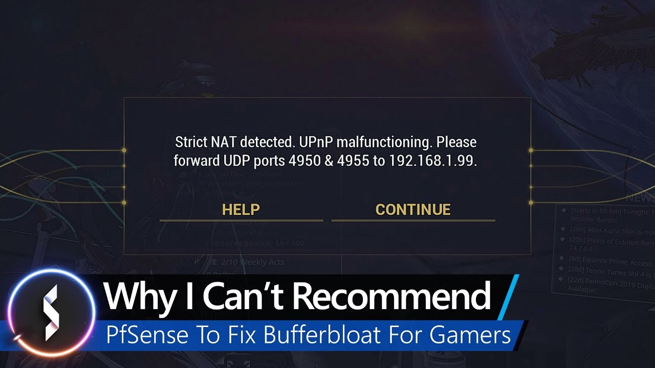

For those not in know on SQM

My use case, we have HIGHLY asymetrical internet so proper SQM is the utmost important thing i have almost one whole second of buffer bolat delay on speed tests.
HOWEVER the “Why I can’t Recommend Pfsense To Fix Bufferbloat For Gamers” video brings up that ease of use topic because PFsense defaults to “always no” THEN you have to find a way to allow whatever it is you are using. great for enterprise but, not for home!

from what i can get gather the REAL deal break is the “always no” and having to reference guides (as commented by a few) to set up a new game server etc etc, in the video linked above some multiplayer game clients didn’t work either or could only allow 1 player.

So i watched the video twice and i cant see where he shows where fq_codel does not work for bufferbloat. He basically complains about upnp implementation not working for two people playing on same lan. Did you have another video in mind by chance?
Also never heard what version of pfsense he was using.
So if he was using one before 2.4 where they added fq-codel option in gui than that also may be why he did not go over it.
