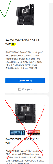

One thing to mention on the motherboards: As a fresh owner of the V2 Asus WRX80 board, I think UNLESS you plan to use a lot of higher power PCIe devices, I would strongly consider the ASRock WRX80 Creator as well. From what I am reading they seem to be a lot faster with BIOS updates.
I talked to Asus and apparently they are working on better memory support and a new support list, but it seems ASRock is faster and already seems to have better support.
I am noticing some little things that could need more polish and the experience is not quite as rock solid as it was on my old Asus X399-A Prime; Sometimes the board takes 10-30 minutes on code F3 before suddenly passing to AA and initiating boot when starting from a USB drive, there are some PCIe errors; I haven’t used the ASrock board, but I hope someone with hands on for that one can comment on this being the same or better. That said, at least in Germany Asus’ support is super fast to answer and seems to be competent for the limited interaction I had with them in the past, but it could vary in your country.
Long story short: Consider both ASrock and Asus’ board.
