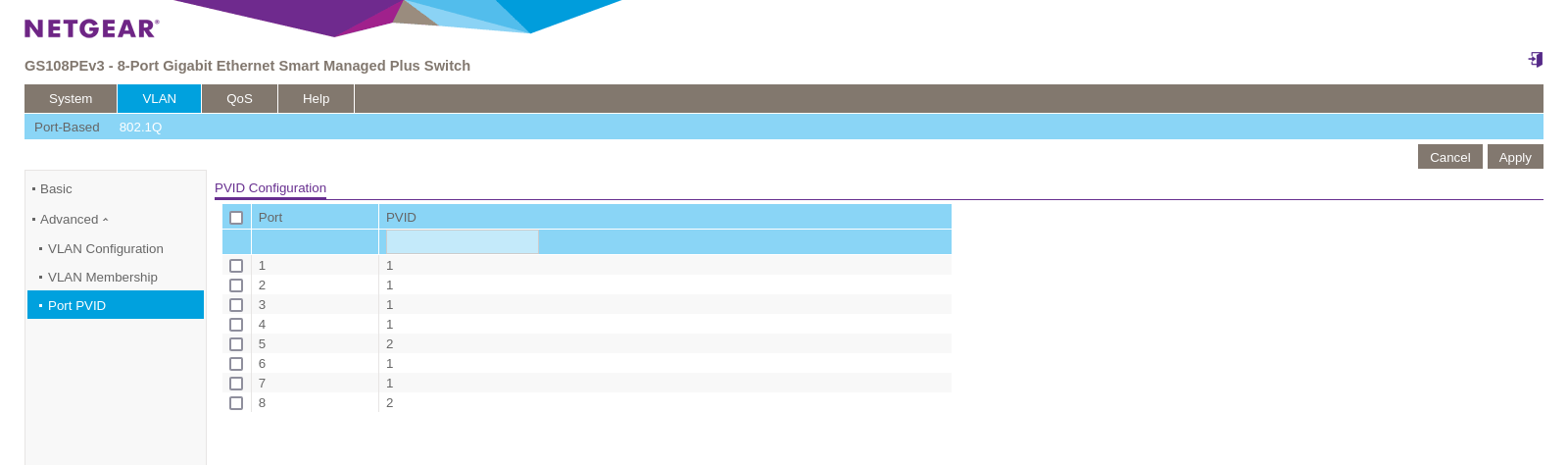

It’s still having trouble. This is the ruckus connection I set for my ethernet
when I run nmap on it
nmap -Pn 192.168.0.1
Starting Nmap 7.93 ( https://nmap.org ) at 2024-04-06 15:16 CDT
Nmap scan report for 192.168.0.1
Host is up (0.091s latency).
All 1000 scanned ports on 192.168.0.1 are in ignored states.
Not shown: 990 filtered tcp ports (no-response), 10 filtered tcp ports (host-unreach)
Nmap done: 1 IP address (1 host up) scanned in 19.44 seconds
This is the switch connection I set to manage my switch
no luck on this side either
Do I need to set the PVID too?
