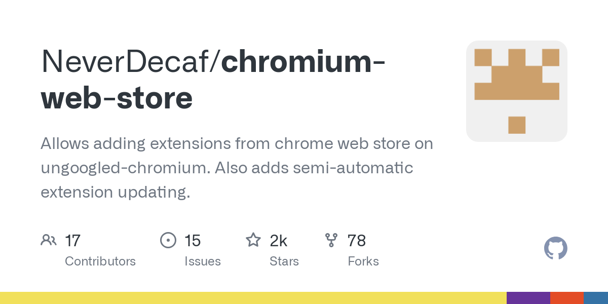

You can’t install extensions from chromium store directly either and you have to download .crx file that you can install. This obviously also means that autoupdate doesn’t work for extensions. There’s Chromium Web Store extension that helps with that though.
This extension brings the following functionality to ungoogled-chromium (and other forks that lack web store support):
  • Allows installing extensions directly from chrome web store.
  • Automatically checks for updates to your installed extensions and displays them on the badge.
