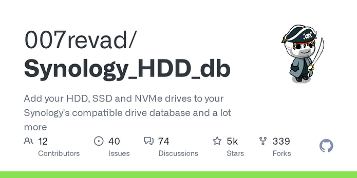

By now lots of people have heard about the deal with DSM marking drives as “unverified”. I get it. The demands of customer service on this sort of thing are real. However, if/when my NAS really does go from its healthy state to a “warning” state I’d rather there not be things in the way of figuring out what its problem is.
I also set it up to run on boot in case the changes get clobbered during a DSM upgrade.

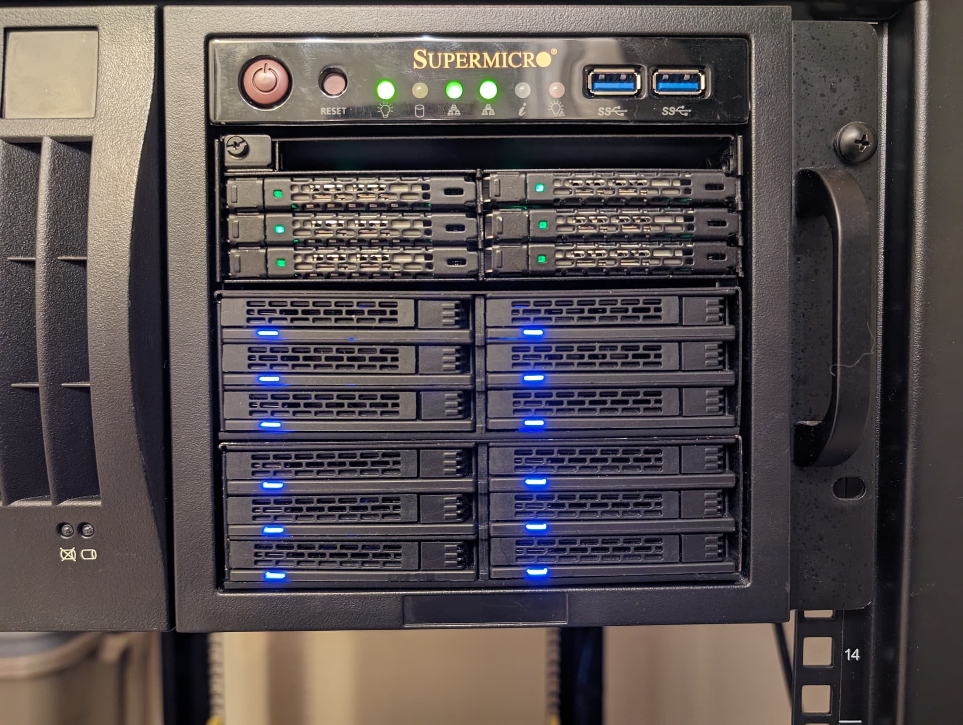

I gotta say, I really like the chassis. It had feet which allowed it to be used in desktop orientation, but I took those off, and stuck rails on it instead. Another nifty feature of the case is that if you decide to rackmount it you can remove the cage housing the 5.25 drive bays and rotate it 90 degrees so all your drive bays aren’t sideways.
The slot for the optical drive in this enclosure doesn’t work, but I didn’t find that out until everything was put together. It’s quite cramped inside the case with all its drive bays populated and all the cables that go with it(did I mention the cables?). I’m not going back to tear everything apart just so I can fix that. USB drive to the rescue.

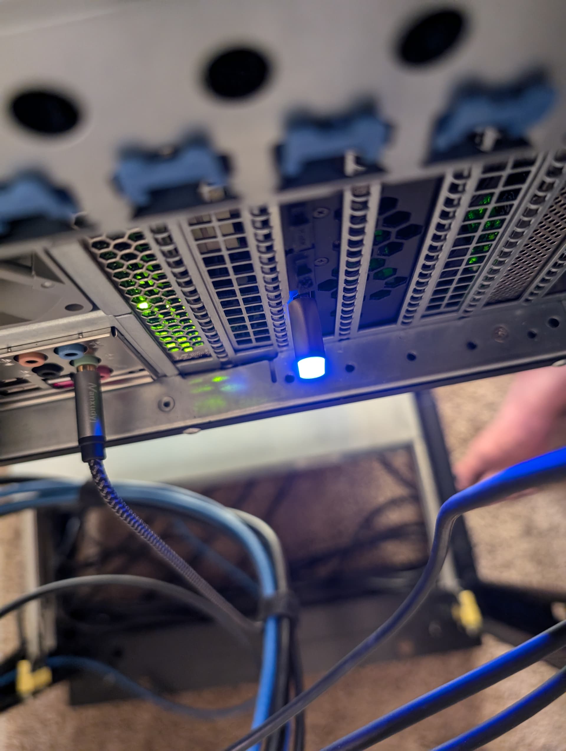

Let me draw your attention to where I used zip ties. Every good project has a few zip ties.
The 16i SAS controller was quite toasty when running, so I strapped a fan on it and was very pleased with the result. This made a big difference.

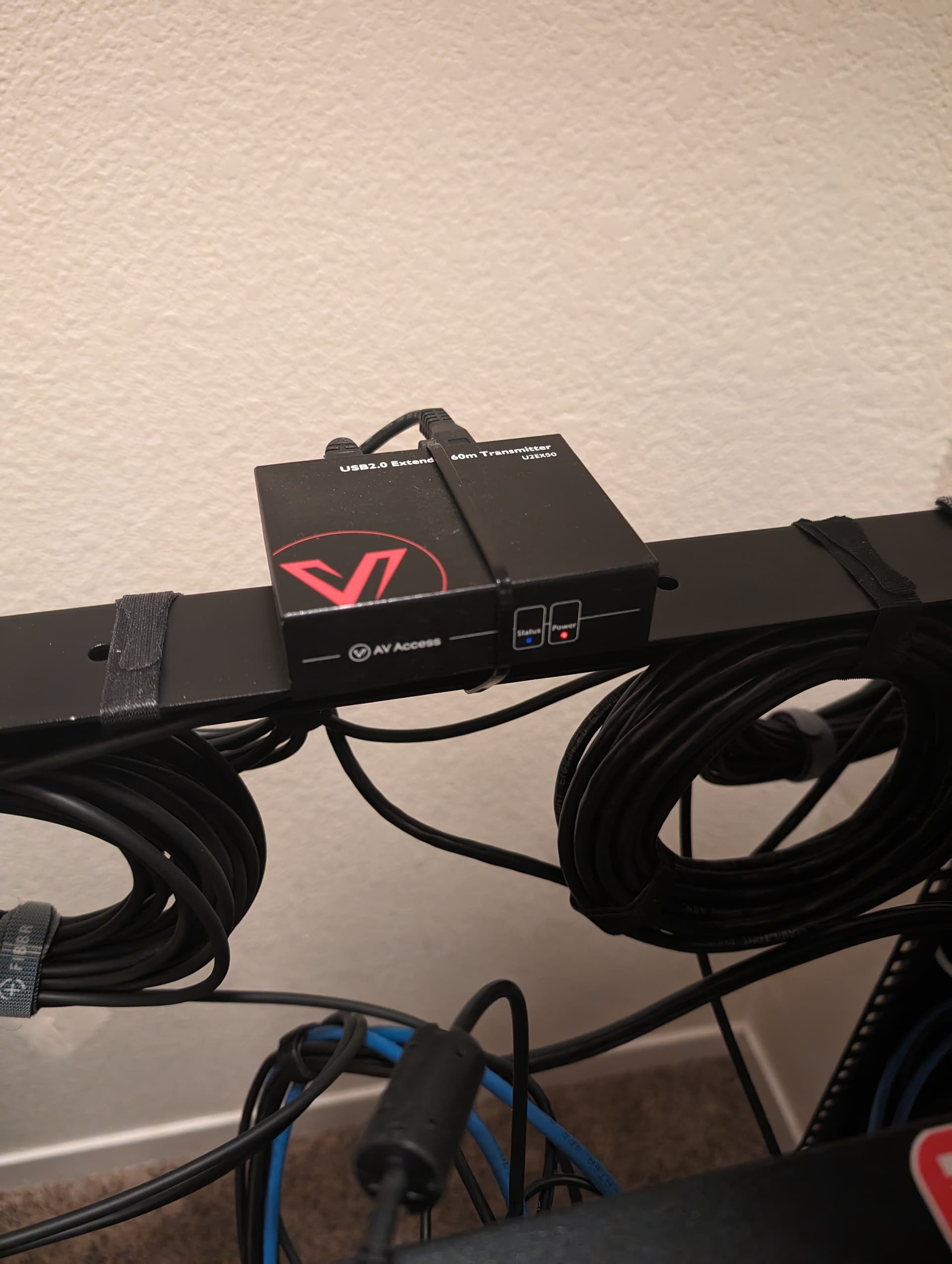

This is a USB over ethernet extender which I’m using for peripherals. Past experience told me this was the sort of thing to cause shenanigans, but there’s been zero issues so far. I zip tied it to the back of the rack and haven’t had to mess with it since.
