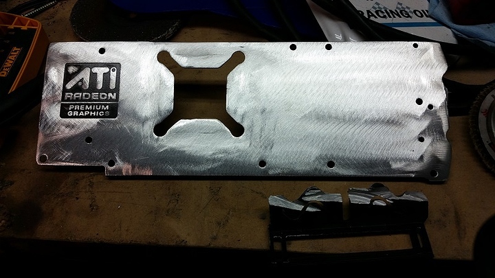

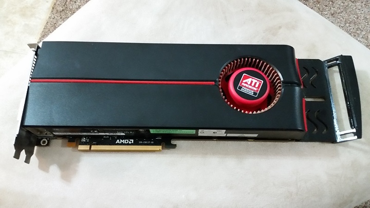

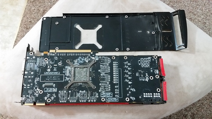

The test fit of this card was very tight to say the least, akward twisting would be required. My issue became justify spending more money on another card or mod the backplate. Since I just blew some cash on a Sapphire R9 290, mod was the answer.

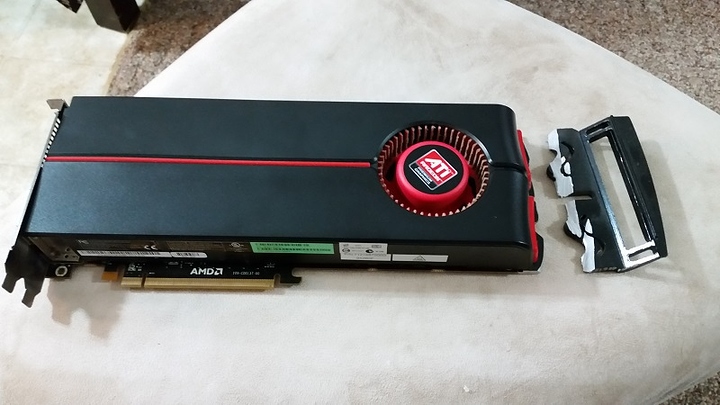

After cutting down the offending plate support ( Intended for specific cases ), I decided to give the plate a unique finish.
The card fits very well now.
