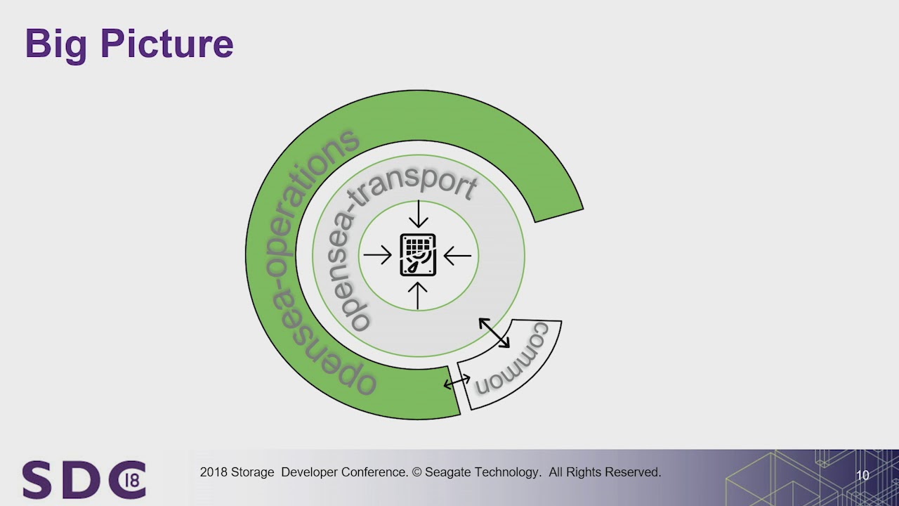

You might as well use sg3_utils or go all out and be interested in openSeaChest.
That tool looks really cool. Nice one
