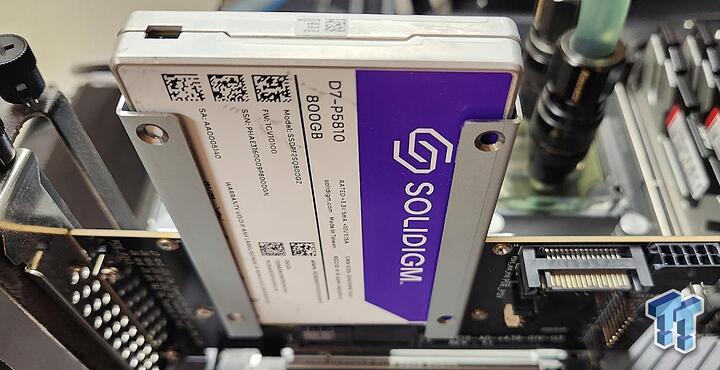

  3. Solidigm D7-P5810 / SSDPF2SQ800GZ01 (800GB, Enterprise drive, U.2, Gen4, SLC, Endurance: 50X Drives/Day).

As you can see, the two M.2 drives, that I’ve set my eyes upon, are 4TB large, only the Solidigm U.2 drive has 800GB storage.
However, the Solidigm drive uses 1-bit SLC NAND, while the other 2 drives are using 3-bit TLC NAND.

If optane is off the table, next best is D7-P5810 , amazing if extreme overkill drive. Perceptible perf gain will likely be minimal or outright nonexistent vs middle tier consumer drives.

For general use Solidigm D7-P5810 and similar drives, but they will not universally best, no drive is. If money is no object or better, someone else is paying, I would take it over any high end consumer drive.
Both extreme overspend though economically speaking. But you cannot get modern SLC drive anywhere outside enterprise segment, where 5k USD is peanut change.

Now if you want actually fast, any general use enterprise U.2 will smoke any M.2 in random iops and better thermals.
