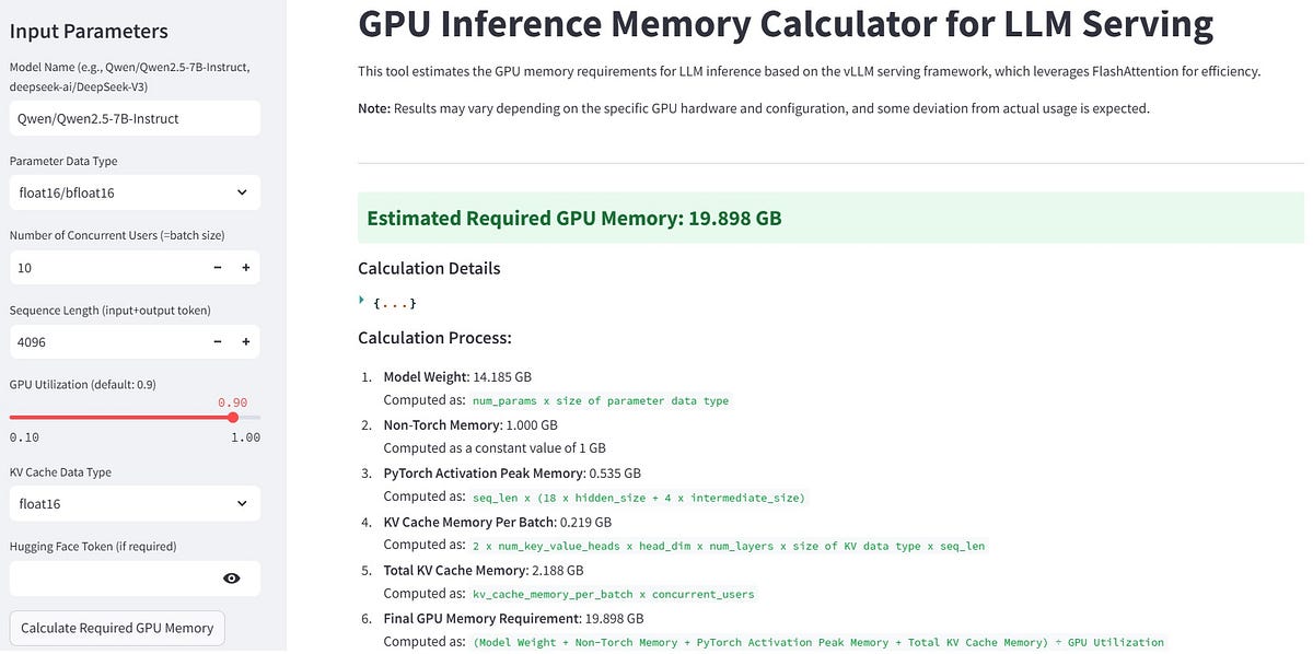

edit: Estimating GPU Memory Given Concurrent Users
