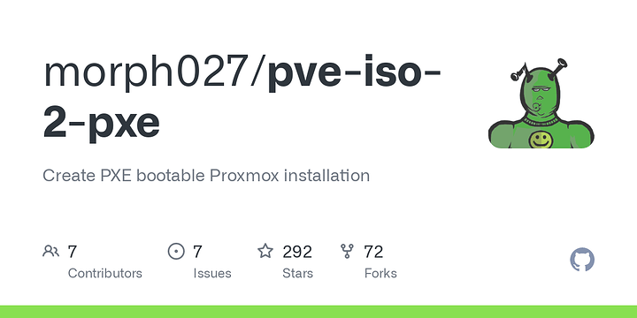

So I am in need to deploy Proxmox on roughly 12 machines and I waas wondering if anyone has a guide or something to setup a PXE server easily. So that I can boot all the machines off the network to install them. There is a github repo for Proxmox PXE but not really sure where to start only done network booting for Windows.
