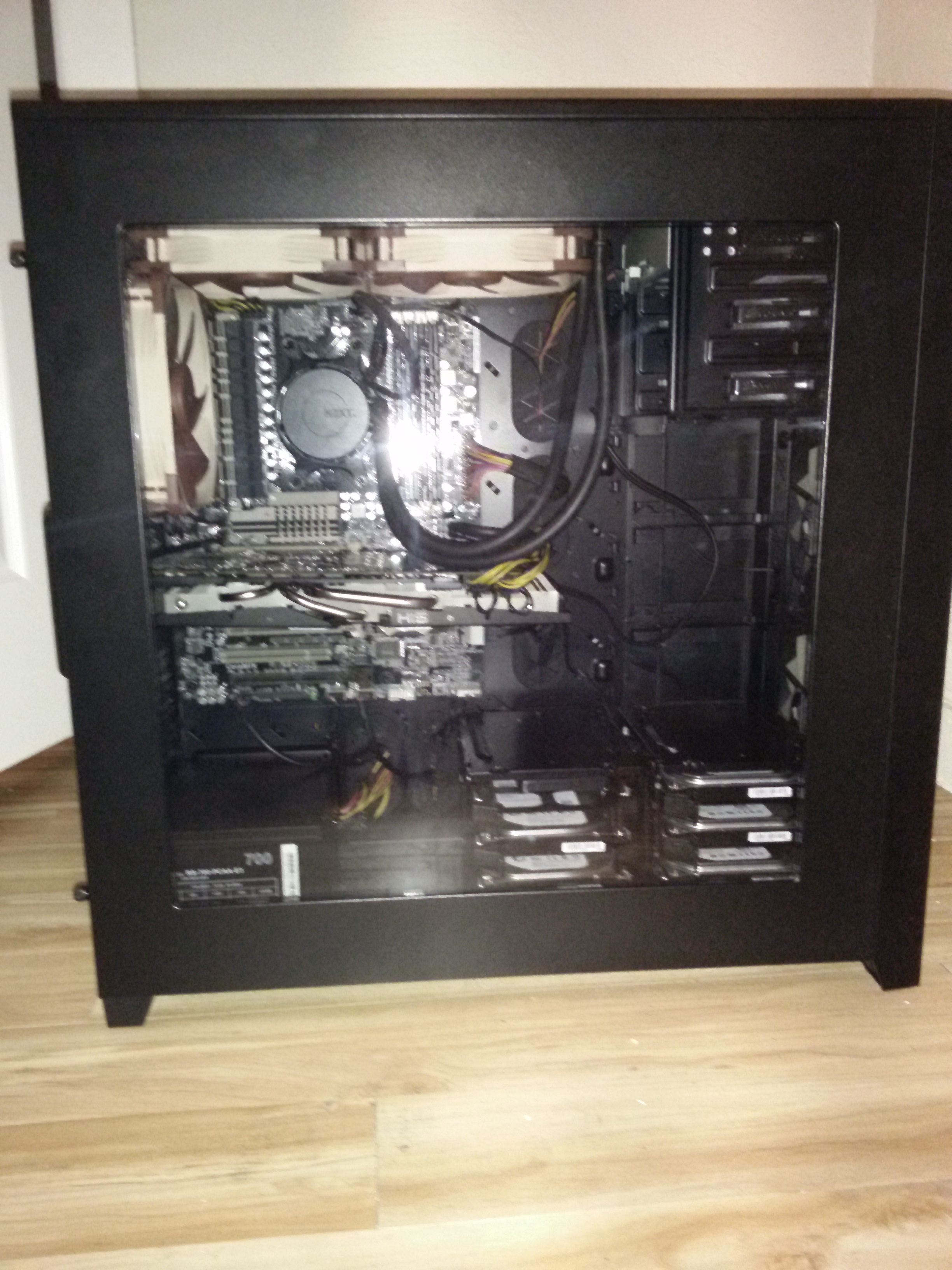

See it doesn't look bad with window on looks normal
I don't understand what the statistics you just said so the noctua aren't good on the radiator? You see my fans how should I rearrange them for best performance? I also have 2 really awesome Thermalright 140mm but have stupid as he'll month on them the screw holes are space like a 120mm so I'll have to custom mount them if I use them
