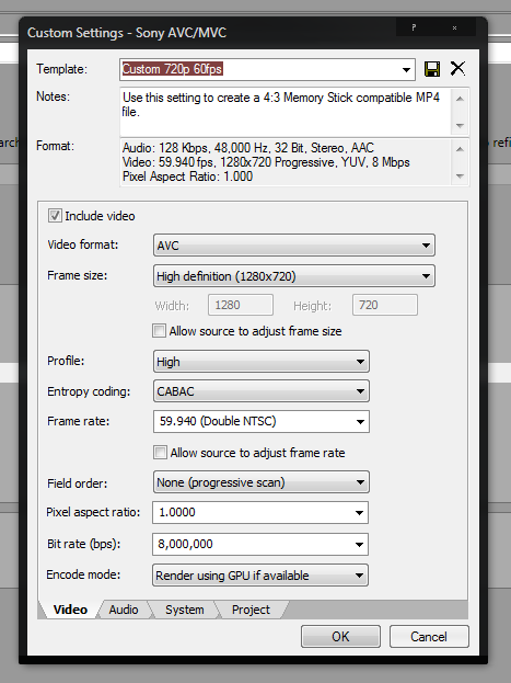

These are my current settings for a 1 min 90MB file: http://gyazo.com/cd74483ad1d36d3168c41d9acfb08439

It depends on your settings. With handbrake I usually set the video quality to Constant Quality RF=18 and the bitrate will vary depending on the amount of motion/dust/whatever in the video. It sounds like you are getting about 13 mbps which is a little more than what youtube 1080p is. So with that bitrate it should look a little bit better than youtube.
If you are targeting a certain file size you should use two pass encoding and set encode speed to medium. I don't think there is much benefit in a slower setting than that it it begins to take forever.
