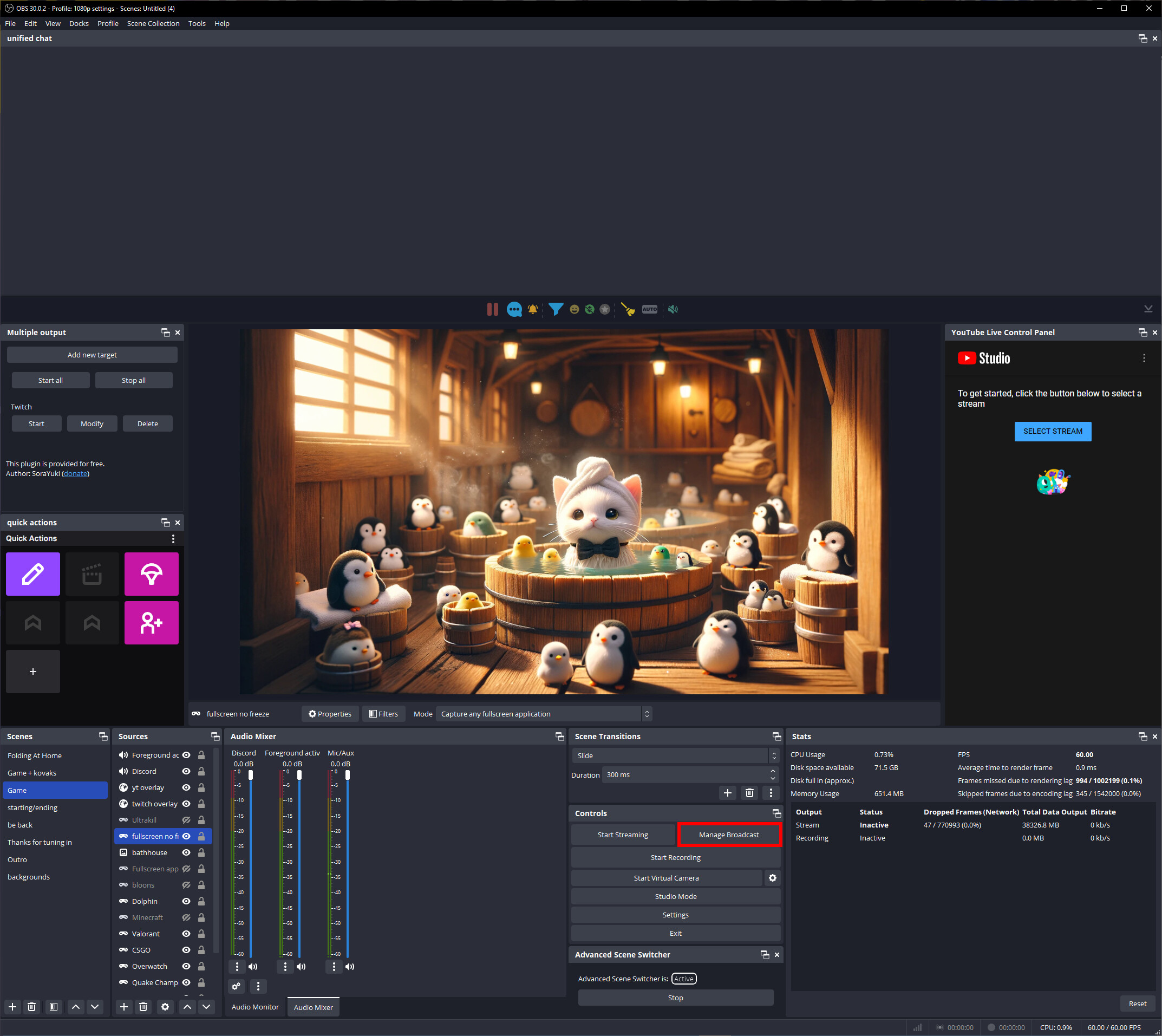

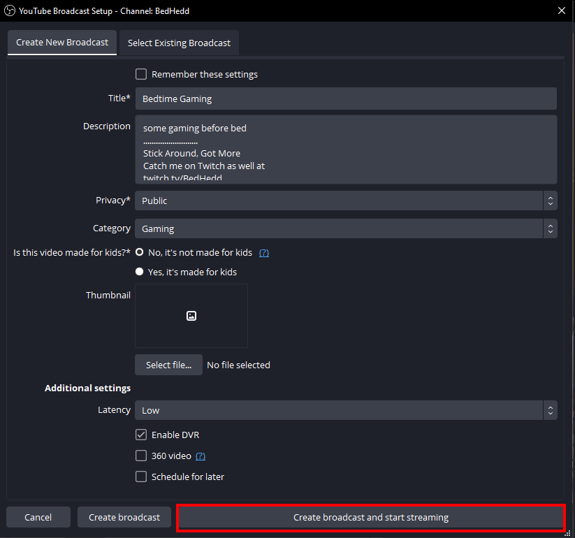

Aside from the go live workflow, the biggest adjustment is switching the default obs sign in to YouTube instead of twitch (which gets moved to the rtmp plugin because going live on YouTube needs a extra step).
Instead of hitting start streaming, you click Manage Broadcast
you’ll then be prompted to create a broadcast. When you are done, just click Create broadcast and start streaming
