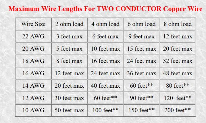

The guage of your speaker wire depends on the length of wire and the load of the speaker. All modern speakers should be assumed to be a 4ohm load but over short distances (2m or so) it doesn’t really mater. I’d just get 12AWG and not worry about it.
images (16)
Oxygen free copper is sort of snake oil, almost all copper wire is oxygen free but there’s no electrical difference between that and regular copper, it really only matters for industrial and chemical applications. CCA has higher resistance than copper so 12AWG CCA is equivalent to something like 14AWG copper, but that’s the only difference. Stick to copper, I don’t think it’s really worth what you save on CCA as you’ll need thicker wire anyway, and watch out for cheap copper wire as often it’s just CCA labelled as pure copper.
Cool I went with 12 AWG
This is a good table, will need to keep it handy
Got it. My runs are 10-12 ft, but good to know
