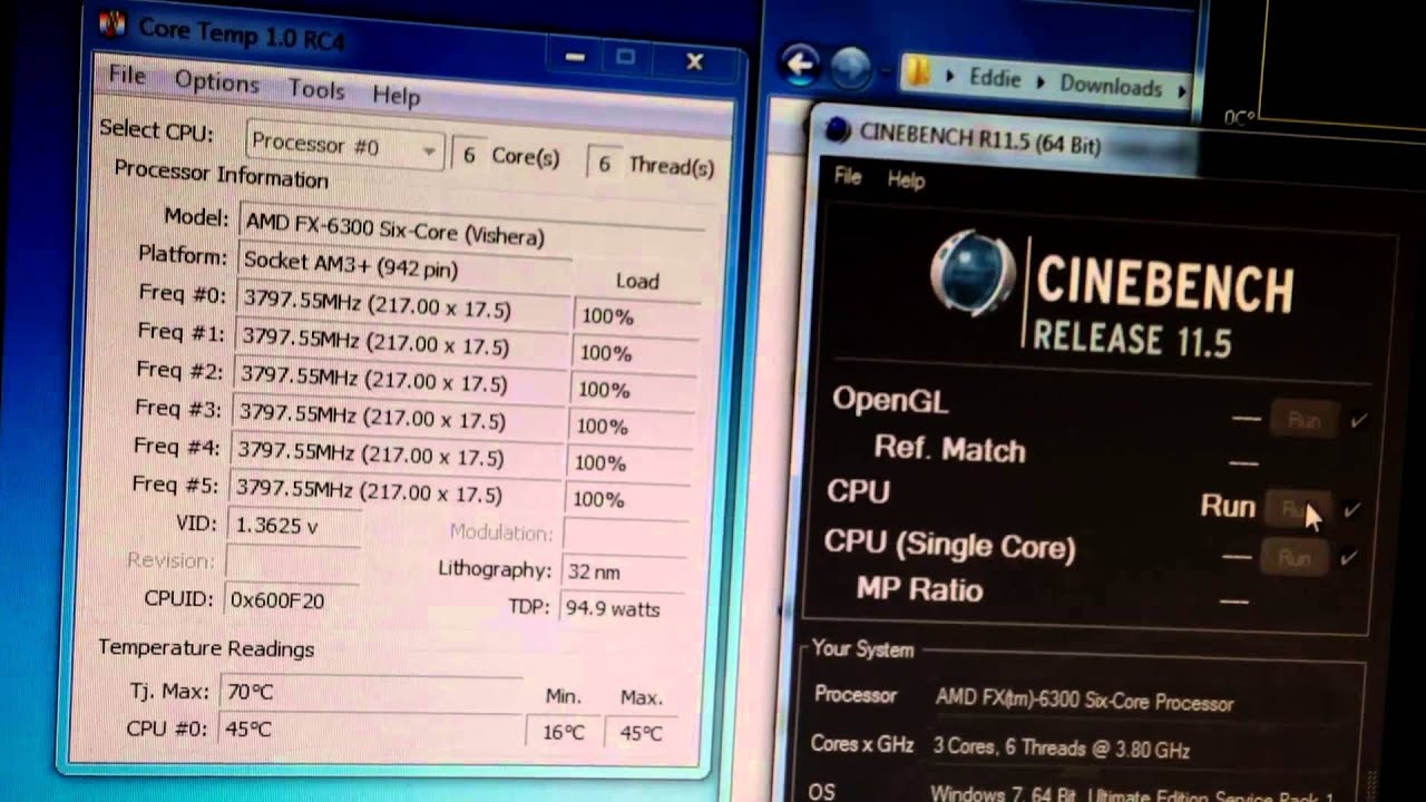

There was a youtube video where I guy did a simular OC to mine but he used a stock cooler:
