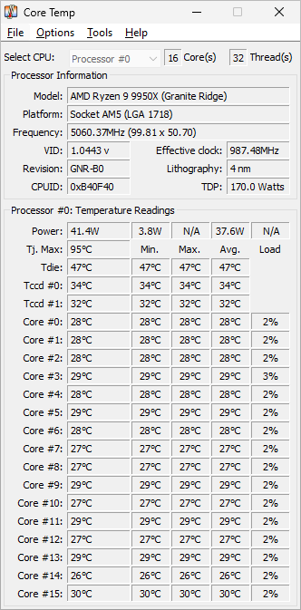

Core Temp has worked very well for me.
http://www.alcpu.com/CoreTemp/
