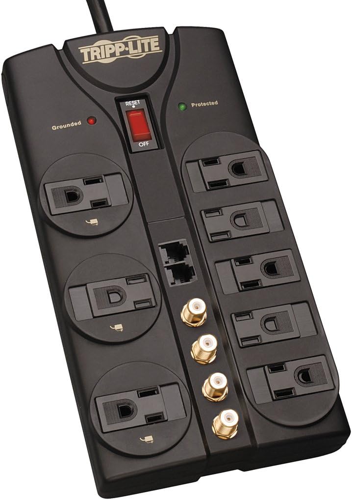

surge protector
that one looks decent ish but I can't know unless I take it apart
http://www.newegg.com/Product/Product.aspx?Item=N82E16842102238
https://www.cyberpowersystems.com/products/ups/pc-battery-backup/gx1325u
im using 2 of theese
cool story bro
well what was the point in posting a surge protector in a thread i made about my ups units?
put the protector before the ups so it protects the ups
