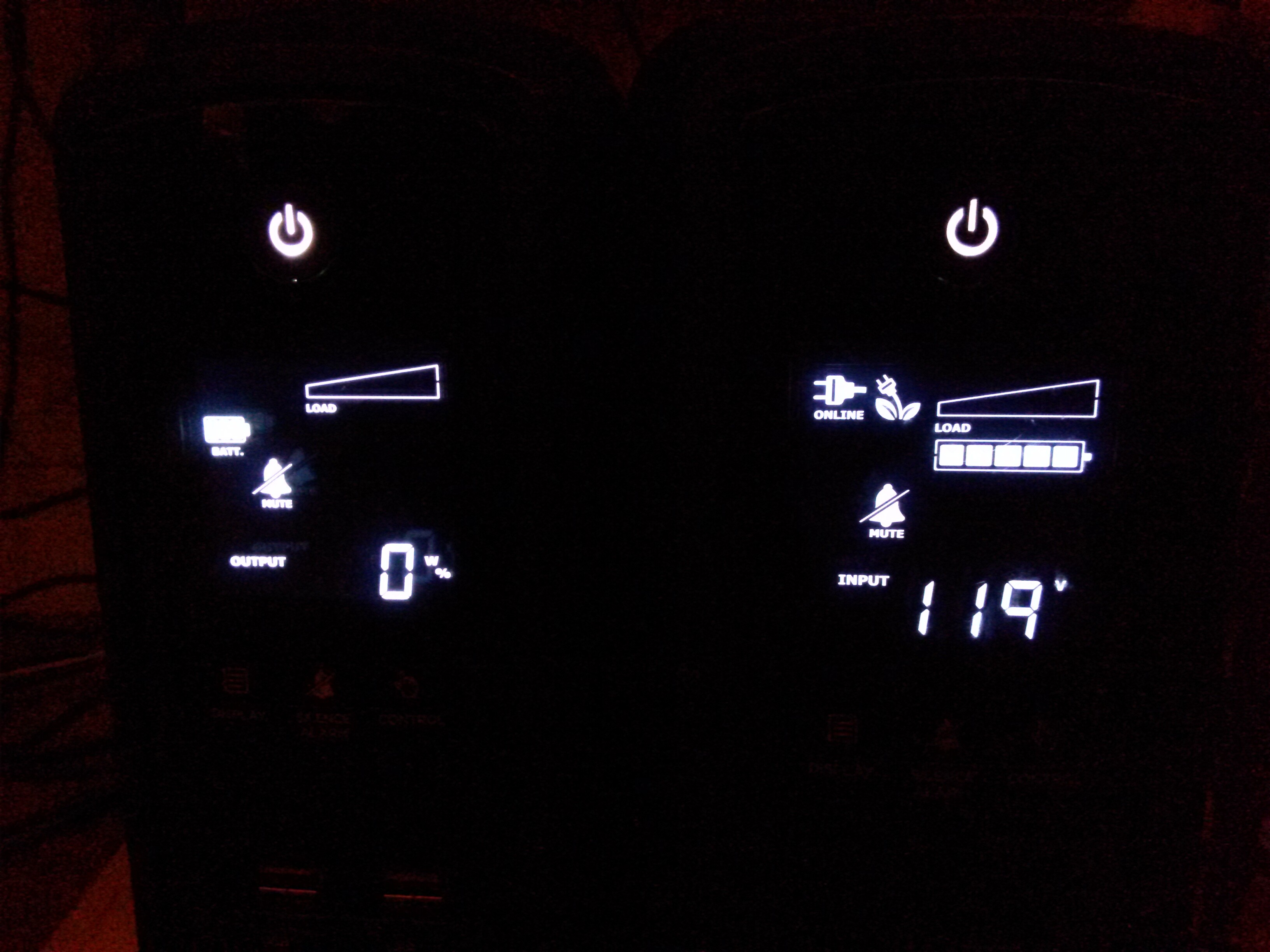

Well here we go mr. Warranty voider
my pure sine wave power supplies hooked up in series with each other
shockingly it appears that when I pull the power closest to the wall they both click in the battery mode temporarily
because of the sudden loss and response time of the first UPS
But then ups 1 feeds pure power to the second ups and it clicks back as if it were into Mains power
not being able to tell the difference between Mains power and the battery output of the first
as I had theorized all along
And mind you I went into each unit and set its "sensitivity" to maximum
Imgur
So I suppose the main question is now which way will I choose to leave them and forget that they exist

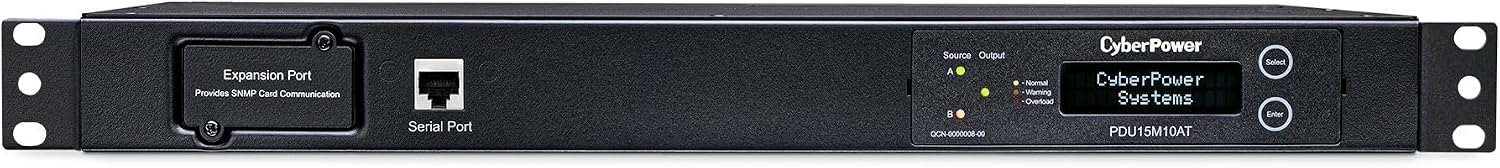

https://www.cyberpowersystems.com/products/pdu/metered-ats/pdu15mhviec12at
The CyberPower PDU15MHVIEC12AT, a 12-outlet (rear) 1U rackmount metered auto transfer switch (ATS) power distribution unit (PDU),
Dual power cords can be plugged into separate power sources to provide redundancy to single-corded connected equipment.
If power for the primary source exceeds the lower or upper thresholds, or if power fails, the PDU will switch to the secondary power source to ensure continuous operation.
The PDU will switch back to the primary power source when incoming power becomes stable.
The current draw for connected equipment is displayed in amps on the front LCD for real-time load monitoring.
