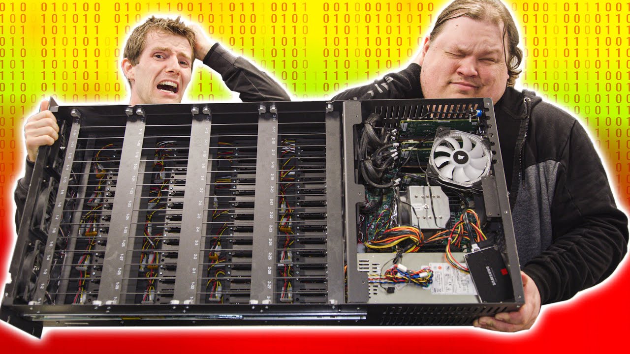

This video?
They replaced a bad cable. Linus sort of stumbles over his description. A “backplane” usually refers to a circuit board with molex and sas connections on one side and connections for drives on the other. It usually contains a port multiplier which consolidates many drives into a single or few sas connections. In this case, 45drives just runs a unified power/data cable for each drive that screws into a bracket so it aligns with the drives when you drop them in. That’s what that whole article you linked was about, replacing the backplanes with cables.

Sidenote/PSA: Based on that video, Linus is using 15-drive raidz2 vdevs across multiple 60-drive systems in a non-redundant cluster. Additionally, he is extending a pool that is 95% full.
So he is running a relatively high-risk cluster with one node that will be extremely unbalanced. It might work out for him, but I would not recommend that config and definitely wouldn’t want to be responsible for it…
It is possible that he is passing each vdev to gluster instead of pooling them in zfs (in which case, balance would be less of an issue), but I kinda doubt it.
