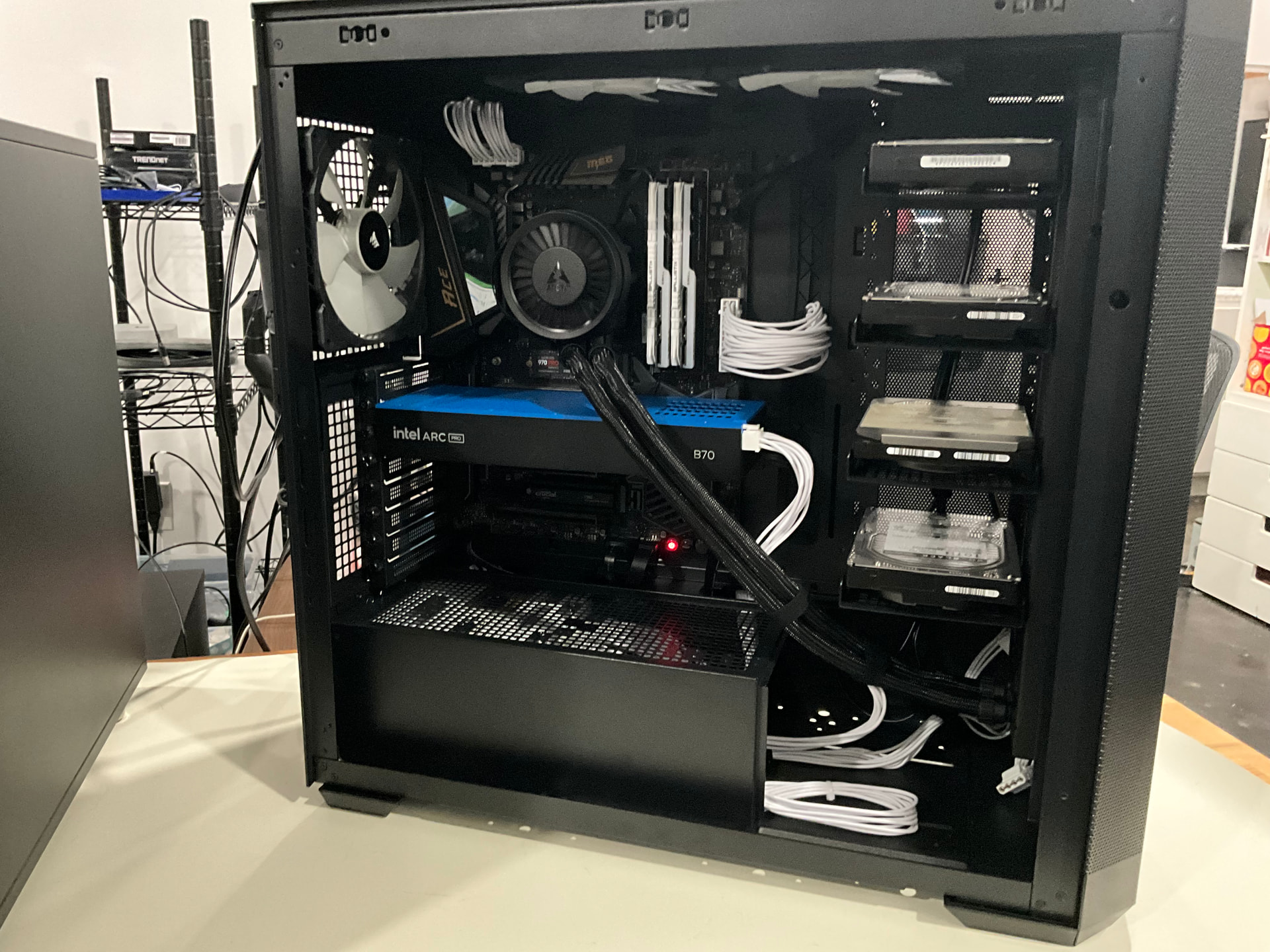

About a month ago I intended to repurpose my 5950X on MSI Meg X570 ACE WiFi with 128GB worth of DDR4 into a VM host, home lab server, local LLM host, swiss-army-machine?.. but things have gotten far out of hand. I’ve bought a bunch of new hardware, investing more in the repurposing of this old system than I did on the 9850X3D system I built to replace it, culminating in an Intel Arc Pro B70 GPU… Long story short the B70 has me feeling buyers remorse. Experimenting with Qwen3.6, Gemma4, etc on this build and on my MacBook Pro M1 Max I find that my MacBook Pro is much faster running the same models. Maybe I don’t have my Linux legs under me yet to have correctly got the llama.cpp/SYCL back end worked out correctly? Should I rethink my build focus and the B70, should I struggle on, any advice or encouragement is appreciated.

As a quick sanity check I started over. I reinstalled Fedora 44 with the B70 installed, updated, installed the Intel toolkits, etc. Still using vulkan/llama.cpp runtime in LM Studios. I went from ~20 tokens/s to ~47 tokens/s running Gemma4-26B-A4B-QAT and Qwen3.6-35B-A3B MoE models. So maybe I had conflicts with vulkan, mesa, and cuda after swapping different GPUs in and out of this computer so many times?

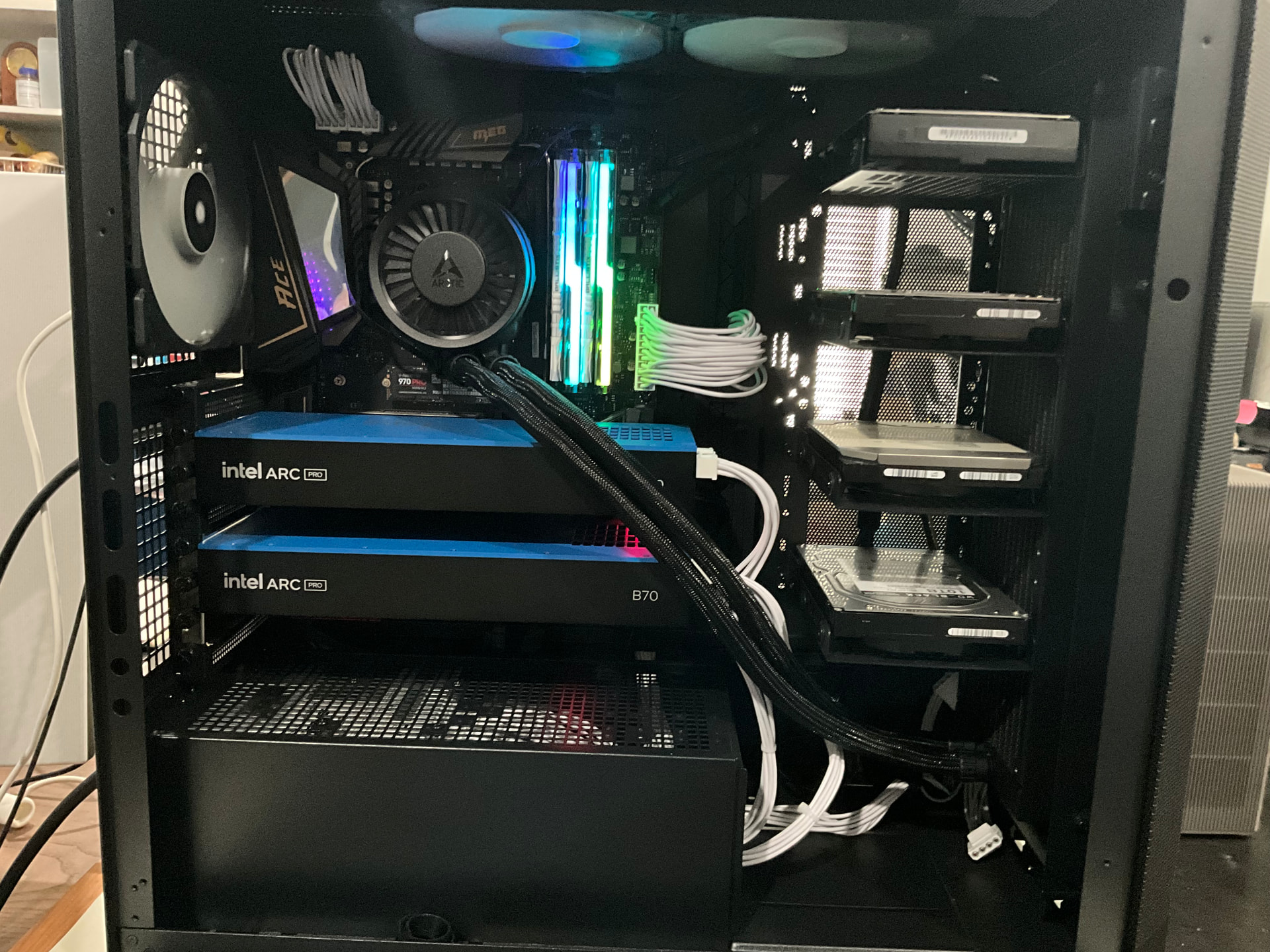

Through not much work on part I managed to get better performance out of the B70. At some point it turns out I did have Resizable BAR turned off BTW, though I did have more than that to deal with. Installing Fedora KDE helped things along. Once I had the first B70 working out, insanely, I got another one. After wrestling with that for a while… Finally as of today I was able to get +80t/s with the same model that is ~60t/s on my M1 Max MacBook. I wish I could systematically go through all I’ve done to get here but I attribute a lot of it just to trial and error at this point. I can’t believe I’ve fallen down this rabbit hole.
