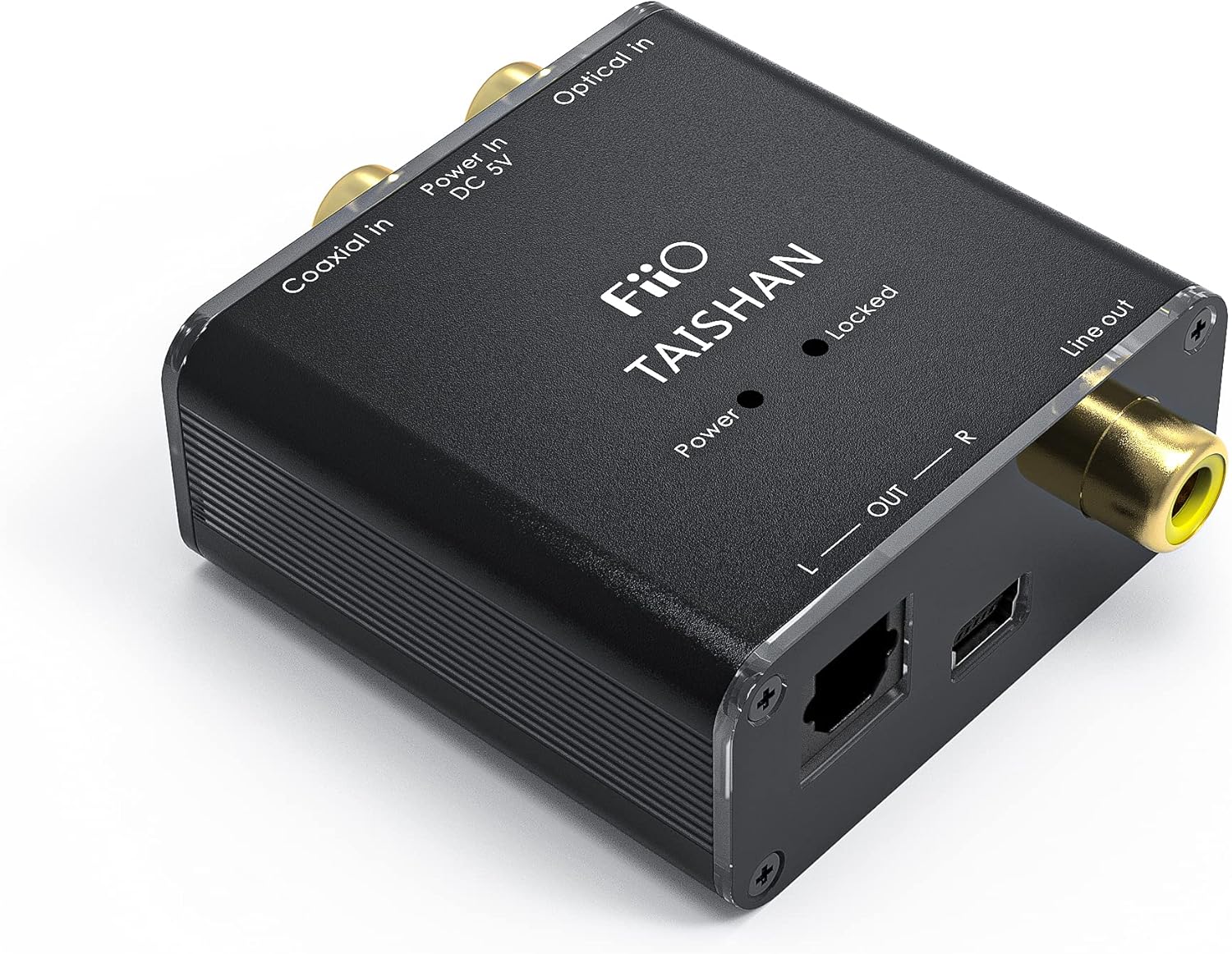

Try the USB port. USB sound cards only cost a few bucks on amazon so that’s worth a try. Chances are you even have one that came with a headset lying around somewhere.
In case the TV decides to not play ball with the USB soundcard, a cheap DAC:
there are hdmi adaptors that have hdmi passthrough for monitor plus jack and optical outputs for audio
Thanks, I ordered DAC. Let’s see how it works.
